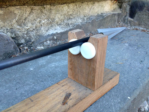

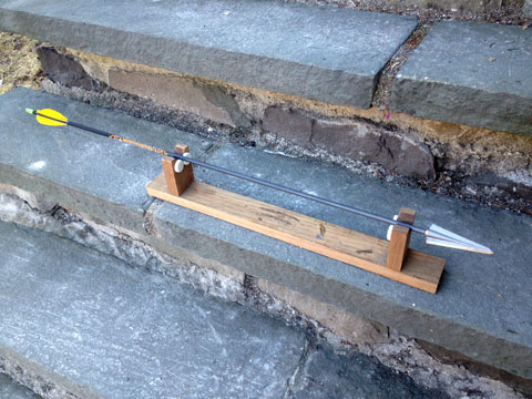

        Another little vid to follow up on the beer bottle arrow straightener. Rollerblade broadhead aligner…

              Clay, very nice, as usual! I’ll throw in a variation of that system, but with not moving parts. The disks are nylon skids that you put under furniture legs. Works just dandy. If the point of the head isn’t exactly right on, usually a quarter turn or so puts it where it needs to be. Thanks! dwc
