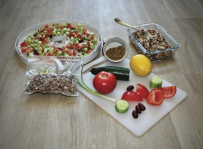

A typical meal: Greek souvlaki, raw, dehydrated, and re-hydrated. The author just added dried, ground venison seasoned with his favorite souvlaki spice recipe to the ingredients in the photo. Note the skinned cucumber and the tomato with the pulp removed.

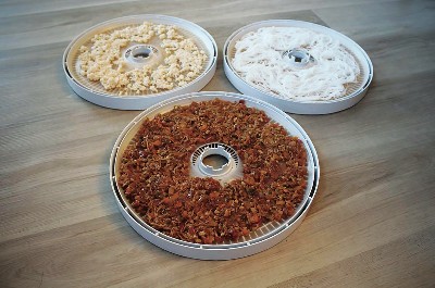

There are two basic approaches to dehydrating meals. You can dehydrate the individual components of a meal and add them together once dry, or you can cook a full meal and dehydrate afterwards. I do a little of both. Choices like chilis, curries, risottos and the like all work well for one pot meals. Simply prepare your favorite recipe using the tips below and dehydrate. Pastas with hearty sauces, salads, Shepherd's pie, Thai food, and mashed potatoes with fried mushrooms and onions are all ideas of component meals. Simply make and dehydrate the components of your entrée and add it to dried pre-cooked rice, powdered mashed potatoes, or dried pre-cooked pasta to round out the meal. Remember to experiment, as variety is the spice of life.

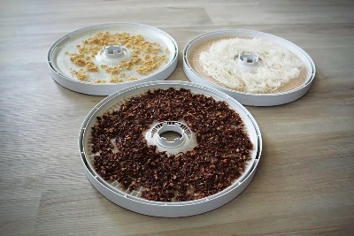

Above—Ingredients for homemade Pad Thai with canned chicken. Below—Dehydrated ingredients of the Pad Thai ready for packaging.

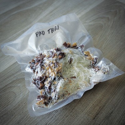

The author's dehydrated Pad Thai meal. An inexpensive sealer, such as a Food Saver, works perfectly to seal out air, and keep foods longer.

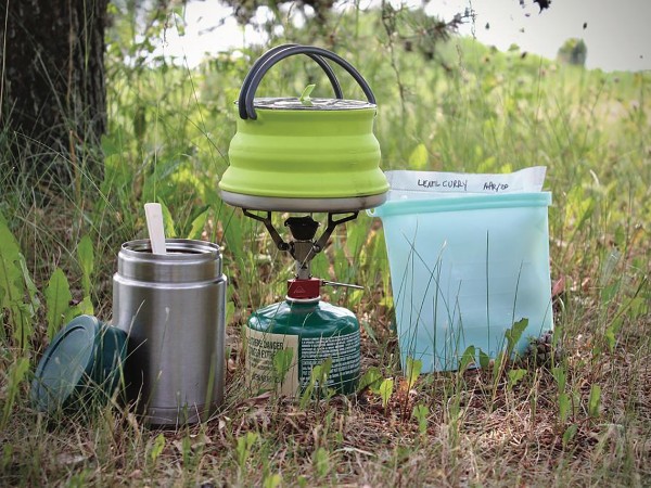

Great article! I cant wait to try to dehydrate some food for this years hunting and camping. Question, what is the insulated jar and the green pot in the picture at the start of the article? Looks like a nice set up! Thanks
Hi Austin,
The “green pot” is a “Sea to Summit X-Pot Kettle” in 1.3L size. Its perfect for what I need, collapsible, durable, and light weight. The stove is a “MSR Pocket Rocket 2”. The food jar is nothing special. It’s the big-box-store “Stanley” from my work lunchbox. It’s handy but a little heavier, so I only carry it when ounces aren’t critical. I found the silicone pouches online.
Thanks for the kind comments. I hope making your own meals enhances your time outdoors.
