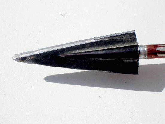

            in reply to: Grizzly tough! #56523
            Next, remove any factory burr from the unbeveled side of the blades with a file or coarse stone. Just lay the file flat on the blade and make a few passes along the edge.
            Then start on the bevel side with a file or coarse diamond stone. Grizzlies have been through a few different factory bevel angle changes over the last few years. Depending on how new or old yours are you may need to remove a heck of a lot of material or if they’re more recent issue, maybe not so much. If you look at the above photo, you’ll see that the bevel extends slightly passed the center of the tanto tip. This is how I estimate a 25 degree bevel. They can be sharpened at other angles but this is Ed Ashby’s “optimum” bevel angle.
            Work the bevel side with a file till you have raised a burr again on the unbeveled side, then switch to a coarse diamond or ceramic stone and continue to polish the bevel. Use as many or few grits as you like. As you do this the burr will continue to get bigger and heavier. Then with a fine grit stone, do just the minimum necessary to remove the burr from the unbeveled side of the blade. Strop the head on a piece of leather or better yet plain old corrugated cardboard and it should shave hair easily. Sounds complicated but after you’ve done a few it’s pretty easy. Let us know how you make out.
            Ron
            sharpster
              Post count: 91
              in reply to: Grizzly tough! #56505
              Michael,
              Sharpening single bevel blades is actually easier than double bevels once you understand what needs to be done and how to do it.
              The first thing I do with Grizzlies is to flatten the tip section. The bulge at the tip is actually excess braze that has bled out during the lamination process. I do so many of them that I use a belt sander but, if you’re only doing a dozen or so a file will work just fine. Just be careful to file the tip perfectly flat.
              Soon as you get through the paint you’ll see that the metal beneath it is brass. Just file the brass off till you see nothing but steel.

                    In his diagrams Standing Bear shows what we might call a “Duplex” or “Compound” bevel geometry, ground on a double bevel blade. That’s two separate bevel angles ground on the blade edge- a “primary bevel” ground at a relatively low angle, followed by a “secondary bevel” ground at a steeper angle to give strength and durability to the cutting edge. This technique provides exactly the same benefit to a cutting edge that putting a tanto tip on a broadhead does for the tip: prevents it from curling over. In fact the two profiles are identical. When you look at a broadhead with a tanto tip, that’s just what a cross sectional view of a knife or broadhead blade with a duplex bevel looks like.
                    Most of us have heard the term “working edge”. To most of us it means a coarse sharpened edge like you get with a file or carbide type sharpener… That is not what SB is talking about. He’s describing the steeper secondary bevel of a duplex bevel, and it’s honed and polished to surgical sharpness.
