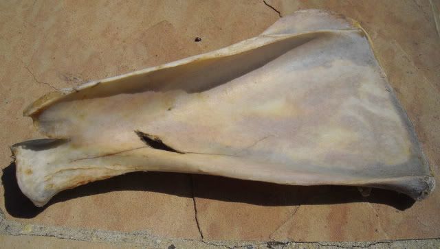

This arrow did not go through the thin part of the scapula, it is at least 1/2 thick.
This is his left scapula and the arrow went in about 10″, no exit though, I have worked up an arrow that should crash through both shoulder blades now.

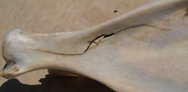

This is the exit side or what you could call the inside of the scapula, you can clearly see the “S” in the bone split.

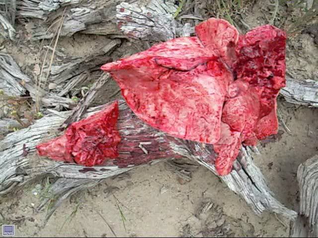

This is a boar I shot this year in his bed @ 9 yards, with a 60lb Centaur 650 grain total arrow weight with a el grandy, this is the path of the arrow.
the arrow went through the ridge breaking it off and going through the scapula, in effect 2 bones.
It went down into the lung severing the right lobe completely off.:shock:
