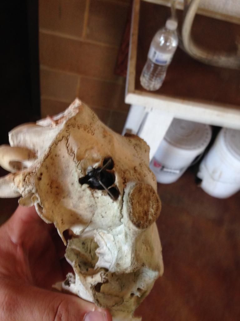

        “Out there” is correct. The extent some go to refute and deny a comprehensive study leaves me shaking my head. The “by golly my 2016 and razorhead will kill anything on the plant….if I hit the vitals” well No Sh!t!!! Although…I’ve personally witnessed people hitting hogs in the vitals with their set ups and NOT get through to the vitals. Lol
        Last time I checked the brain was a vital…this pic was taken at MCAAP. They hold trad only draw hunts there. Notice the bone growing through the opening in the blades as well as the shed antlers.
        Stuff happens and an inch might as well be a mile when you
        are only an inch short of a kill.

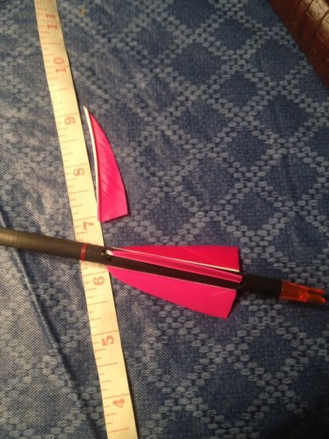

                                Post count: 34
                                Thanks! I have a 3″ parabolic chopper, I just take a pair of scissors and cut the back 1″ off. Work pretty good and I can get 3-4 cuts from a full length feather.
                                Toehead
                                  Post count: 34
                                  2″x1/2″
                                  Fly just as good as 3″x3/4″
                                  675grain arrow and 29% Efoc. Don’t know what to do to hit the 30% mark. Took me a month to get this formula right! But shot it with my broad heads and they fly great….when I do my part and pull through the release and follow through.
                                  Couldn’t have done it without your help Tradbow friends of FOC forem and of course thanks to Dr. Ashby as well. 14 days will be the true test of these “Pork choppas”
