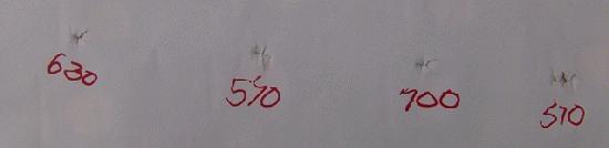

      We quickly ruled out the 500 and 750 spined shafts. However, ALL the others were flying very well. Very little wobble or wagging could be seen with the naked eye out to 25 yds. He was shooting groups of about 3.5″ at 20 yds. with all the rest of the shafts. I don’t mean each spine, I mean shooting all of the diferent spined shafts into a group at 20 yds. ! These shafts, with all that weight up front, flew like darts.
      We finally had to break out the paper to see which shafts actually were flying better. This is the results:
