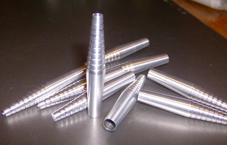

        My son is 14 and has taken quite a shine to the bow and bowhunting. Only problem is he has a very short DL and therefore it’s tough for him to generate a whole lot of “umph” (I think that’s the technical term). My thought was to go to a “skinny” shaft like the VAP’s or Carbon Flash(es), with plenty of FOC and a sharp COC head like the Grizzly.
        Problem is Carbon Flashes have NO sort of broadhead attachment system and the VAP’s , in my opinion, is ,well, let’s say less than desirable.
        So I came up with my own solution….
        The aluminum ones weigh in at 48 grs. the brass at 165 grs. I made a test arrow a while back and figure that with his 24″ arrows, he’d need 238 grs. up front to give him a 32% FOC and a 410 gr. arrow out of his 40# bow. These ought to work out just about right.
        I thought you folks might appreciate something like this, so I thought I’d post it up.

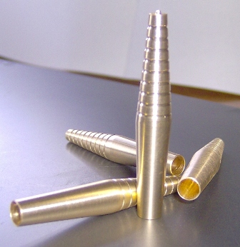

      • Munsterman
          Post count: 25
          Brass outserts…
        • handirifle
            Post count: 409
            I thought I posted a reply before, but I guess not. Excellent work. Did youndo those on manual lathe or CNC?:x
              Now that would be sweet as peach pie to have 32% UEFOC coming out of a 40# bow. Should connect with a heck of a thump.
            • Munsterman
                Post count: 25
                handirifle wrote: I thought I posted a reply before, but I guess not. Excellent work. Did youndo those on manual lathe or CNC?:x
                they were done on a CNC.
                Troy, I thought the same thing. It also eliminates the typically weak hinge point that the factory inserts for these shafts have.

                • Munsterman
                    Post count: 25
                    I’m a machinist and the shop I work at allows us to do projects like this if the machines aren’t tied up. Really, for something like this, it would cost someone a fortune to come in with a small order for parts like this. The programming and set-up time alone would kill you before a part was made. I did the programming and set up on my own time (it was for my kid – priceless).
