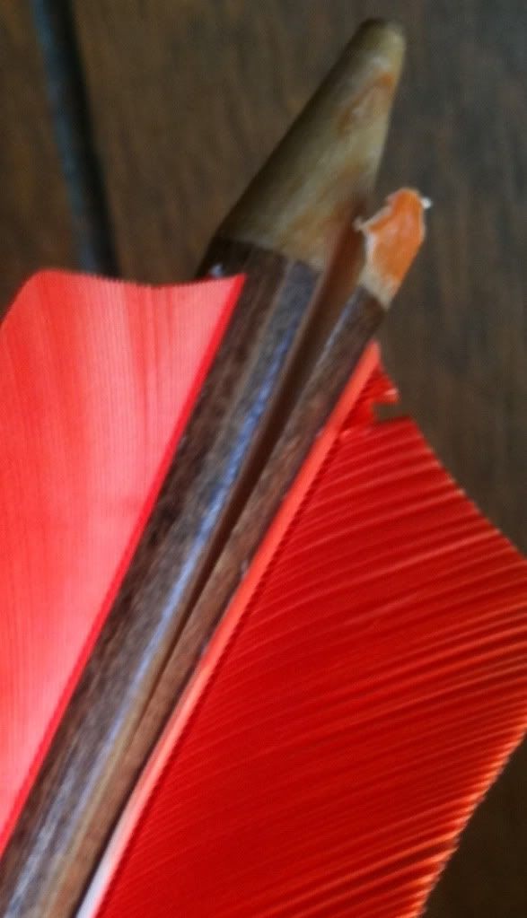

        In a failed attempt to swap out nocks, this happened:
        I assume my only recourse is to cut it shorter just past the sliver.
        Lesson learned: Don’t attempt to remove pieces of a nock by cutting TOWARDS the arrow tip! BTW, I didn’t slice into the wood at all. The glue held and just pulled up the sliver.

          Looks nasty, did you have the nock positioned wrong or did you just not like that nock? I got them off by heating them up but you have to be careful! I have a dozen cedar shafts ready to taper and finish off! Waiting for my 3Rivers order of nocks and points and my taper tools!
        • LimbLover
            Post count: 299
            I just melt them off Pat. Heat them a bit..wait till it gets goey and pull it off with pliers.
              Call me crazy, but I would work some wood glue under that sliver, tie it down, let it dry and put on a new knock. Of course, if you don’t feel comfortable doing that then don’t do it.
              Otherwise, I would save that shaft for scrap. If I break one at the point I just cut a piece from the donor shaft and add it to the broken one the same way you would add footing.
                I second what Duncan said. Between the glue in the split, and the nock holding it all together, it should be fine.
                You’re just going to shoot it into a deer and ruin it anyway…:D

                  Gorilla glue is wonderfull stuff:)
                    Awesome, thanks guys. I’m glad I asked!
                      Nothing beats super glue Loctite. Respectfully.. Gorilla Glue stinks.. strong yes.. but as a poly glue it foams up a lot, which is definitely NOT good.

                        I use a sharp knife and shave it down until it’s off.
