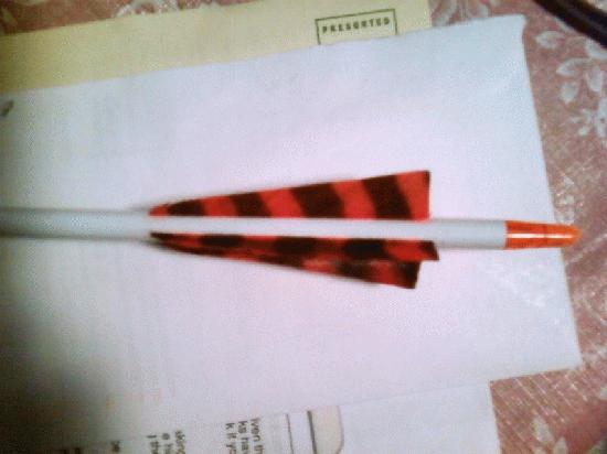

                      I made some 5.5″ ones a few years back with the chopper and glued ’em up with a dramatic helical. And they were almost as loud as a flu flu. I would say the less helical and shorter the feather though, the less wind resistance and less noise.
                        I think Ill just stick with parabolics. Probably like those in your avatar. Might try out four fletch.

                          Etter1 wrote: I think Ill just stick with parabolics. Probably like those in your avatar. Might try out four fletch.
                          I’ve shot and hunted with four-fletch this past year since talking with folks on here and researching Dr. Ashby’s work, and they’ve worked great for me. The feathers in the avatar are hand cut wild turkey from a bird a friend killed, and are very, very quiet.
                            My vision on small pics isn’t the best, Carl, but they look more like shield cuts???
                            Regardless, a friend who did feathers for a side biz, ground and chopped, he said that wild turkey are far stiffer than domestic because domestic birds are force raised to kill quickly and get to market, and their feathers do not develop fully in the time allowed…
                            I believe his point was that the wild feathers are more durable.. I’d THINK (don’t know) that being more durable, the barbels remain intact longer. I’ve noticed when I use commercial feathers, I often find barbels ripped loose from practice shots and they are farm more noisy than ones intact…
                            If that is logical or real, perhaps then wild turkey feathers remain quieter, longer???
                            That way early post of mine about the found banana cut shaft that literally made a screaming sound going down range, that was some pretty HIGH cut feathers… purple as I recall… and several posts suggest height is a noise factor…

                              They are hand cut almost identical to the feathers in your picture. Sharp scissors, masking tape, a ruler, and a steady hand. Made a grinder jig out of oak and flat stock aluminum and I can crank out a dozen feathers (and a pound of dust) in a few minutes.
                                cpbiv wrote: They are hand cut almost identical to the feathers in your picture. Sharp scissors, masking tape, a ruler, and a steady hand. Made a grinder jig out of oak and flat stock aluminum and I can crank out a dozen feathers (and a pound of dust) in a few minutes.
                                Carl, if you are referencing my picture, those are the A&A design… supposedly the delta wing right angle tail end causes least drag and noise.

                                    Doc, I got them as close to the A&A design as possible. I also have a few with 4 fletch 2.5″ parabolics. They fly like darts.
