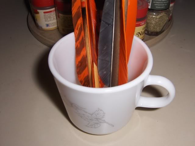

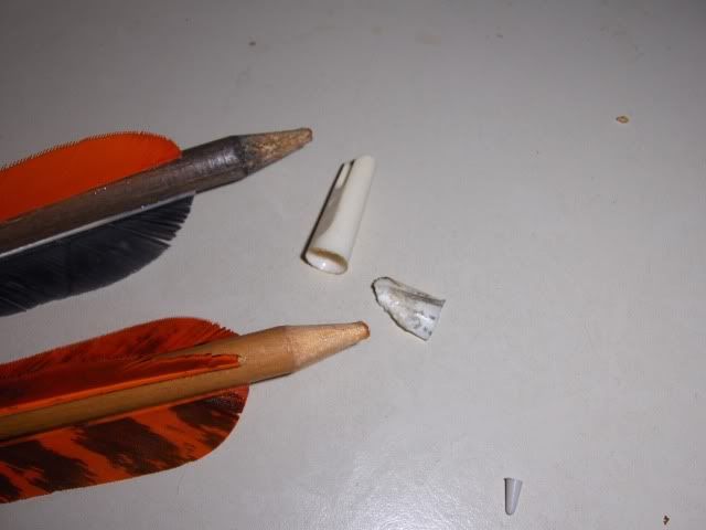

                I did the hot water-softening of one of the nocks, then cut it off with a utility knife and it worked OK, not great as I ended up nicking the wood a bit (my learning curve is LONG:roll:). Learned a lesson: my feathers were too close to the nock to allow clean Tru-Center redoing of the nock tapers with the 5/16″ guide attached, so I had to do it without the guide. I was careful to try and get as straight a re-taper as possible, after I cut a 1/16th off the end. It worked fairly well as the nocks seem to be pretty straight. I used a lighter to burn the nocks and then twisted the nocks off as best I could. Guess it worked. No pretty, but effective.
