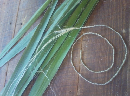

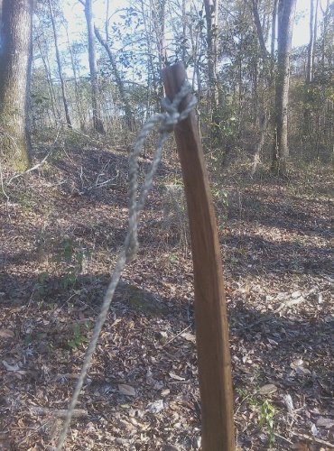

        Finished this yucca bowstring…….So far so good!

          Tailfeather, looks good! Let us know how the natural fiber string works. I know that’s how some of the “primitive” strings were made, as well as from sinew.
          Rich
            Too cool!
              Way cool! Whether plant fiber or sinew, the fibers are too short and many must be twisted together to make a bow-length string. I’ve long wondered how “they” (that is, “we” way back when) did that–got all those short pieces of fiber twisted together in a way that won’t pull apart under the tremendous stress of drawing and releasing the bow. Any light you could shed on this, tail, would be appreciated.
                Truly impressive. My hat’s off to you. Nice pics too.

                    Well, I’m a beginner but I’m learning. Like you say, the fibers are too short and must be continually spliced together throughout the length of the string.
                    First off, when you being twisting the fibers into reverse twist cordage, you start with one tag end longer than the other so they don’t need splicing at the same time (a no-no….much like laying short hardwood floor pieces next to each other). As you get within a few inches of the tag end, you gather another bundle of fibers and prepare to splice them in. You can either overlap the new bundle and the single tag end by a few inches and continue twisting, or form a “u” with the new fibers being twisted into both strands of the cordage….thus being stronger and less prone to pull out. On a bowstring, I think it’s best to use the “U” method.
                    None of this makes much (if any) sense in writing, but seeing it in person it’s pretty easy. I find the hardest thing to do is to keep a consistent string diameter while continually splicing in additional fibers.

                                    So out of curiousity does anybody have any idea on what sort of lifetime a yucca bowstring might have?
                                    Also how fat does such a string have to be in order to have the necessary strength to handle something like a 50# longbow?
