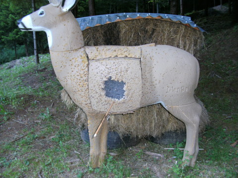

                                    Shot 20 and 25 yrd. Fishtail too the right 10 yrds then too the left. Never had luck with the 10 yrd thing. Heres my first shot at 25 yrds after adding 25 grs too point weight. Still too stiff.

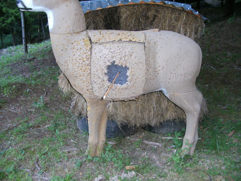

                                  • skinner biscuit
                                      2nd

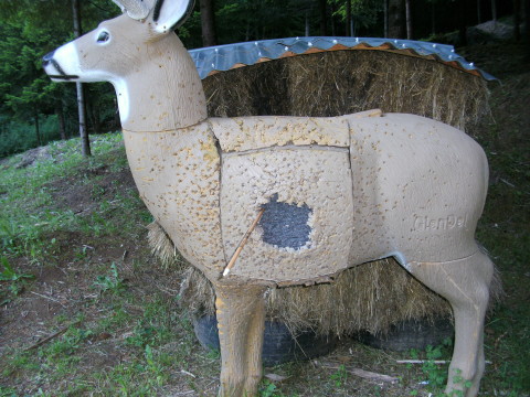

                                    • skinner biscuit
                                        3rd
                                          What’s your bow weight? What spine arrow? From your arrow weight of 420 grains, that suggests you are shooting a 40lb bow…
                                          The only time I have seen a bare shaft correct itself (going from right to left, or up to down, etc) is when it is way out of tune with the bow. I am guessing you are shooting a shaft that is way too light for your bow, and way too stiff. You may want to try increasing your point weight in larger increments.
                                          If you are shooting carbon arrows, you can easily go up 50 grains before seeing much effect.
                                        • skinner biscuit
                                            Steve I’m shooting a 61# @ 28″ recurve. I draw 26″ so around 54-53#. Shaft is a GT7595 with the weight being 768 grs. 315gr test point,two 5 gr brass washers ,100 gr insert. and 25 gr footing.
                                              Where’d I get 425 grains from?
                                              Everything looks right except for the spine of your arrow. If it was me, I’d go with a GT5575 arrow. Since your draw length is relatively short, you have plenty of room to work with.
                                              Make a bare shaft. Glue all your stuff in the end. Then begin taking 1/2 inch at a time off the nock end. Just pull the nock, cut off, and reinsert nock. Repeat till you get good arrow flight. When you get closer, you can take less off…
                                              If you try to make the arrows you have work, you will end up with an arrow that is way too long (not that too long is really all that bad) and way too heavy.
                                            • skinner biscuit
                                                Went back to the GT5575. First thing I did was remove the footing as being at 2″ it was up against the shelf. Made me a 1″ one out of a old 2216 shaft from a hodgepodge box of arrows.Cut a 1/4 inch off arrow till I got good flight.Slight impact to left.Some nock high at 10 yrds, but level at 15,20,25,30 yards. Might do a little bit fine tuning but I think I’ll wait till I get a half dozen.As of now arrow weight 681 grs. foc 30%. Thanks Steve!:twisted:
