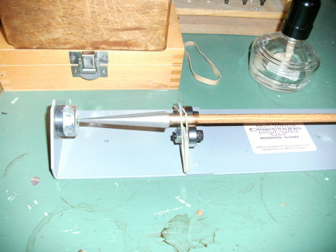

        Hello all, when tuning your tuffheads with the Dixon tool.if putting a footing on your arrow. Do you spin it with the footing (easton 2216 1″) or put the footing on later.? The footing rests on the first bearing. If spinning with footing should I put a loose footing on the second bearing.?

          Detail to your circumstance is lacking(pics make all very clear) but in general you want everything on the front, to be installed before testing. Both tester bearings ride on arrow shaft. Keep in mind all can be aligned, but still theoretically possible that if you had greater mass off center,(tied outsert for example) to the center line of arrow shaft, the arrow still would not spin true. Similar to a tire with a load of ice causing it to want to wobble.
          Use caution not to flex arrow when spinning. some models offer a 3rd bearing which can be used under where your hand will spin. 3rd bearing is a bad idea unless your arrow is perfectly straight.

                  I have built 4 arrows with the footing on.1 in the works. All 3 spun true and fly great.

                        Skinner, thanks for the pic. I had a bad assumption from your first post, even though I looked at the Dixon, I just now noticed it has fixed bearing points. I have the Firenock APS and all bearings can be moved anywhere along the tool length(loosen thumb screw and slide), and also qty. of bearings added or removed as much as you want, hence my comment about a 3rd bearing under the spinning hand to prevent flex that causes false readings. Now I see your dilemma from your initial post. Even though your outsert is riding on front bearing per pic provided, because it is machined and therefore assumptive to parallel with the shaft, I still would have suggested spinning with all on using your Dixon. Never would I suggest using a 3rd bearing per your pic….light pressure to spin is the better option.
