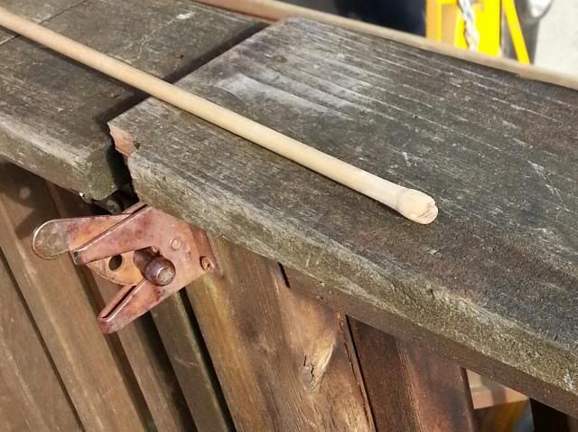

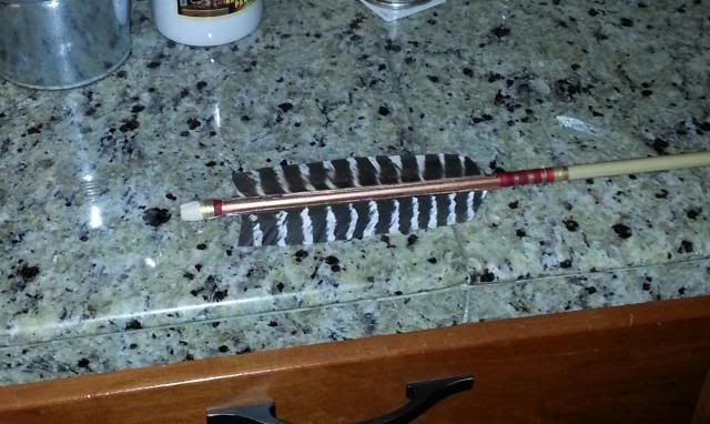

                  how about a picture of the arrow you shot? I’d like to see how you made the taper down / taper up transition.

                      Kind of difficult for me to get pictures up on this site. Has kind of an hour glass profile. On thumb rings…practically all archers shoot from the opposite side of the bow. A few Mongolian horse archers shot off the left side. Thumb rings are good for shorter horse bows due to finger pinch and really not needed for a long bow

                          Kevin sent me these pics to get on here for folks to see..
