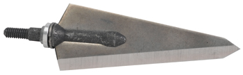

        Has anybody had any experience with these broadheads? They look like the Ashby’s at about half the price.

                • Ed Ashby
                    Post count: 817
                    Can you post a picture? If these are the same as the ones I’ve seen they don’t have a very desirable ferrule fade in. It’s bulbous and abrupt. I’ve tested several of the double-bevel Steel Force, but have not yet tested their single bevel version.

                    • Ed Ashby
                        Post count: 817
                        That’s the same ferrule design I tested on the double-bevel screw-in. That ferrule fade-in is more abrupt than that of the Samauri, with that second ‘step-up’ towards the ferrule’s rear. Even the ferrule fade in of the Samauri (which matches that of the SilverFlame) is more abrupt than I like. Having the very best possible ferrule fade-in isn’t important on many hits, but on some it can become a big, big factor. It’s more critical as the animals get larger or the arrow force you’re working with gets lower.

                          • Cottonwood
                              Post count: 311
                              I have the SF Sabortooth 140 with a 75 gr threaded addaptor, and they fly great. We will see how they perform on game this year.
                              But here you go on the SF BH that your talking about.
                            • tom-wisconsin
                                Thanks for the pics Cottonwood.
