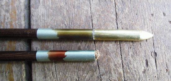

          Far be it for me to ever offer advice on such advanced things as this—especially with wood, but since the damage seems to occur below your external footing, at the junction with the field point… have you ever considered over-footing your footing and letting it extend over the break point onto the point?
          Just a wild thought looking at your picture.

            why not use you aluminum footing as shown, but with a screw in adapter. It’d be like you just cut the end off an aluminum arrow and slipped it over your wood shaft. That’d fix any breaking problems between the tip and footing. Seems like I’d seen somewhere that you’d done that in the past.

              Clay — Yes, I tried that before but you can only get alum inserts for alum shafts and that creates a whole new weak point.
              And in both cases, double-sleeving and screw-in adapters, at that extreme of manipulation you might as well be shooting carbon or aluminum, the value of true wood shafts has been so diminished with add-ons. But thanks for the perfectly good suggestions, both of you.

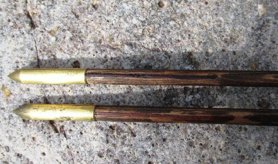

                                          Thanks guys for all the good info. Thanks to a tip from Steve Graf–one of those “Now why didn’t that occur to me?” deals–I used 4″ long hardwood splines inserted across the grain to strengthen the fronts of the shafts. In stumping with Ace blunts I was unable to break a single one. I did lose some FOC by removing the 20-grain aluminum collars, but I’m still over 20% with total weight just over the minimum 650 grains. This is what I’m hunting with … or would be if the rain would ever stop, plus I’ve been annoyed by a combo of minor med problems. So basically, it’s been a non-season for me. I heard the first three bugles the evening of the 7th and the rain began the next day. It’s raining buckets this minute. In such prolonged conditions the elk go to ground and their voices go silent. So I may, or more likely may not, get a chance to try the new arrow setup on an elk this year.

                                                  Reddog — Things are in an uproar here right now. Give me a few days and I’ll get a photo and explanation to you. It’s not a footing, but just a thin spline of hardwood inserted into a slot cut with a band saw and glued in place. I’m no engineer but guess it at least quadruples the strength of the business end of the wood shaft.

                                                      Here’s the best I can do for now. Reddog, as I have no more shafts so can’t do a step-by-step. In the left arrow you can see the thin red line which is the spline. In the right arrow I’ve highlighted it with a felt pen for better visibility, which is why it’s a bit wobbly.
                                                      Using either a tapered or blunt-end shaft, measure back the distance you want to spline to extend and mark–I used 4″ from the tip. Longer would be even better but I just don’t trust myself to make a straight cut much longer. Now use a straight edge to draw a line–and some eyeballing is required–parallel down the center of the shaft from tip to stop mark and aligned so that the cut will be 90 degrees, perpendicular, to the shaft grain. I have an el cheapo Craftsman bandsaw and the table has a gap, or slot, running straight into the blade that’s perfect for using as a guide to feed the shaft in. I really don’t think you could do this with a hand saw. Carefully feed the shaft into the blade to the stop mark. Now turn the shaft over 180 degrees and feed it through again to clean and slightly widen the slot. I used 11/32 and wouldn’t care to try it with anything slimmer, though it likely can be done with a steady hand. A spline no thicker than the width of a wood matchstick is about right, any kind of hardwood. I took a sheet of bow lam wood and marked it to 4″ length and 11/32 width and cut out all the splines I needed for the job ahead of time. Now use a piece of new stiff medium-grit sandpaper to smooth the interior of the notch on one side and then the other. After a while you can move to a doubled sheet so that you’re widening the slot on both sides at once. When you have a snug fit with the spline wood–not so tight it bulges out the shaft–coat the spline with waterproof wood glue (I use TiteBond3), insert and align and clamp lightly till dry. (I learned right off that a C clamp can easily dent soft spruce and now use padded-jaw spring clamps.) When dry, use a razor to trim any excess spline then smooth with fine sandpaper and refinish that portion of the shaft and you’re set to go.
                                                      This by no means turns a softwood shaft into a carbon shaft, but it definitely makes it significantly less prone to breaking, sufficient so that I now feel, after meaningful testing, that I can ethically use them on elk (after I had one break last year behind the head). It’s tedious work, rather like fletching or tying flies, and offers the same sort of satisfaction if you’re in no hurry. But if you set up like a factory line — cut all the shaft notches, sand ’em all, etc. it goes pretty fast. Good luck, Dave
