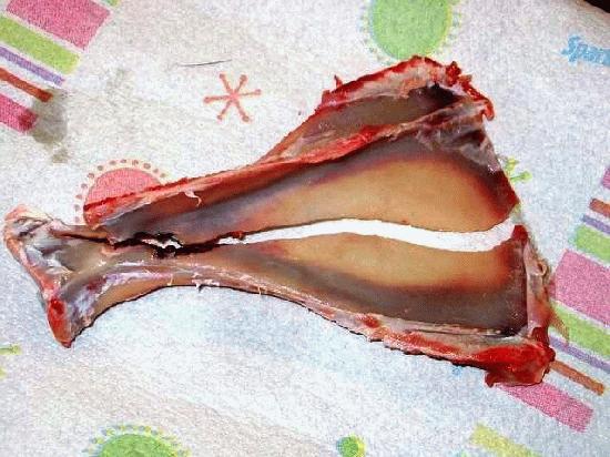

            Without naming names, there is one popular single-bevel out there that has really soft steel. Look for heads in the 53R range. Other issues include shape and size, with long narrow heads being better penetrators that maintain more twist when penetrating tissues than do shorter wider designs. The thicker a single-bevel, the wider will be the bevel shelf and the more consequent torque, so thicker is better than thinner. A couple of otherwise great offerings are simply too expensive for the average hunter. And while this problem is gradually disappearing, some heads still come far short of hunting sharp, and with hard steel this can be a real problem. So, as with bows, knives and other tools, while there are many good choices available, the one that stacks up closest to the Ashby research “winner’s list” is Tuffhead. If you’re using carbon shafts I recommend getting most of the weight from the head rather than beefed-up internals. While I’ve had great results on elk with the 225s I know shooting nothing but 300s for elk. I personally would not use the 190 for elk because it’s thin, though I’m sure it’s dandy for deer and other mid-sized game. These are one very interested and I hope open-minded man’s opinions based on extensive personal experimentation (I won’t call it research) and years of studying and testing Ashby’s research results. Tuffhead sure ain’t the only game in town, but at this point, all things considered, it strikes me and many others as the best broadhead investment we can make for lethality, MA and structural integrity. And better yet, it’s a Ma-Pa operation, not some huge industry.
