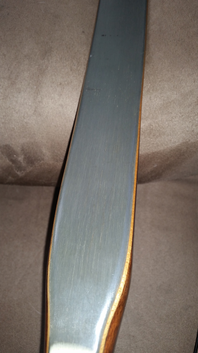

        I have a Recurve Bear Kodiak Amo 60″ 50# with one crack around 2 inches I need to know if is possible repair is a fiberglass or not.In close to de raiser.
          Need picture. your description is not enough.
        • Anonymous
            Post count: 19

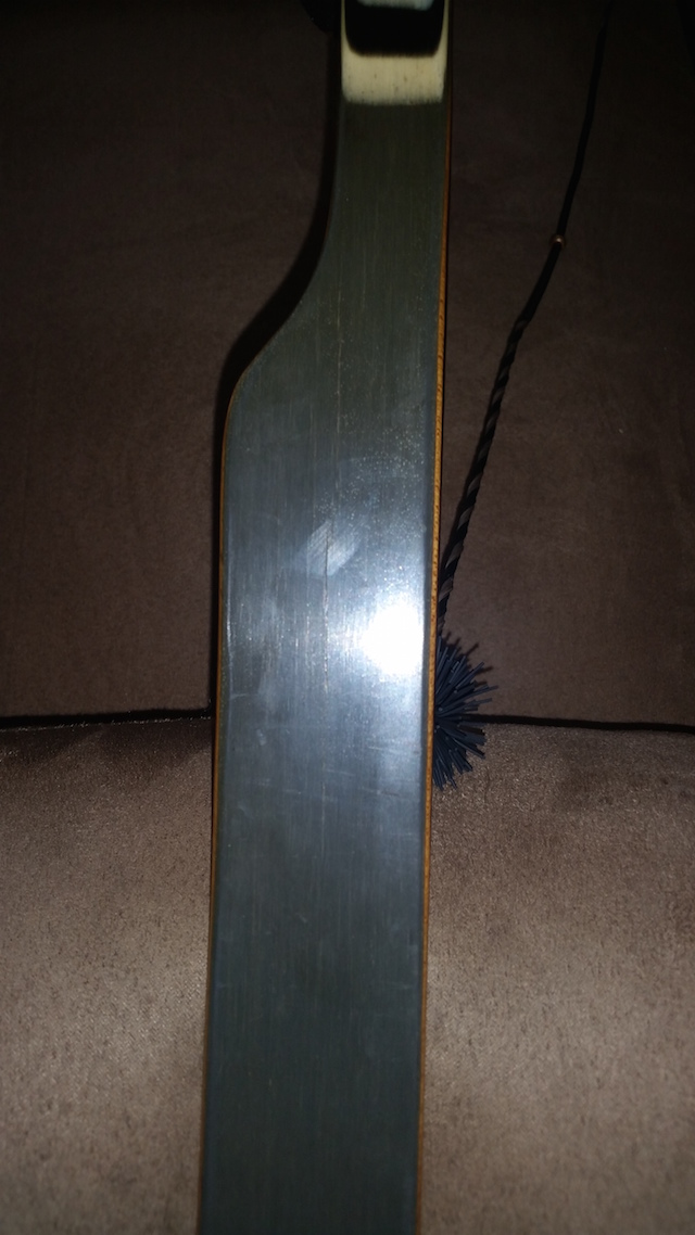

            Both limbs have a crack.
              Cracks that run the length of the limb don’t cause structural problems. They are fairly common, especially in older bows. I don’t know of a way to repair something like that.
              If it was me, I wouldn’t worry about it.

                          Yes, and the guy who runs this business, John Rafferty, is someone whose word you can trust. I sent him a Super Kodiak with a nicked limb. He worked on it and sent it back to me at no charge, saying it could not be safely repaired. I went ahead and shot it on a few occasions and sure enough, eventually it was ready to fail. (Which I avoided experiencing.)
                          Looking at your pictures, I think you may not actually have a serious problem. Trust John on whatever response he gives you once he has the bow.
