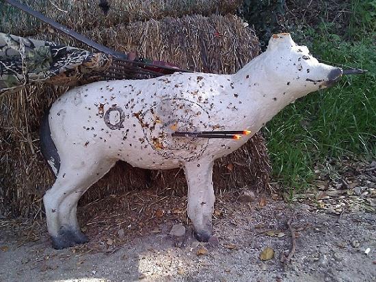

                                  Hey Doc, & Troy, cant seem to get my bare shafts to fly…………lol

                                      David,
                                      I see what your talking about. Can’t say for sure which shaft is off due to the angle of the pic, but it looks like the points are just about in the same spot. However, the nocks are just not there.:D
                                      Might need to work on that release alittle more. LOL!!!
