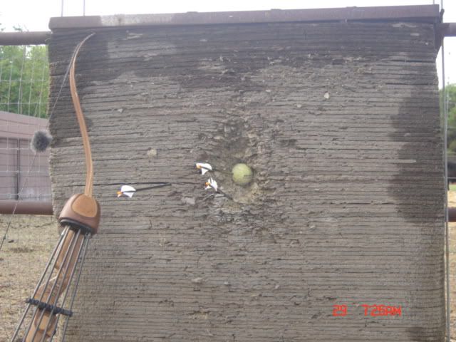

I fabricated a frame which holds 2′ x 4′ x 1/2″ sheets of celotex sheeting. Celotex sheeting is what they used to put on the sides of houses before the bricks go up. You can get it in 4′ x 8′ sheets so you can get 4 panels from each sheet which you stack on top of each other like a deck of cards. Using the fabricated frame and threaded bar stock you can compress the stack which makes for the best and most effective backstop I’ve ever used. I shoot at mine almost everyday and I built it over 13 years ago. It is just now getting to the point that I need to replace some of the panels.

Brett, cool set up, looks like you have the same problem I used to have though. If you miss you have to yell duck, but then the cows just stand there and look at you, lol. Definatly is a good way of replicating buck fever, because of fear of hitting the expeinsive cattle:lol:
Brett, nice looking place you have, like the targets.
