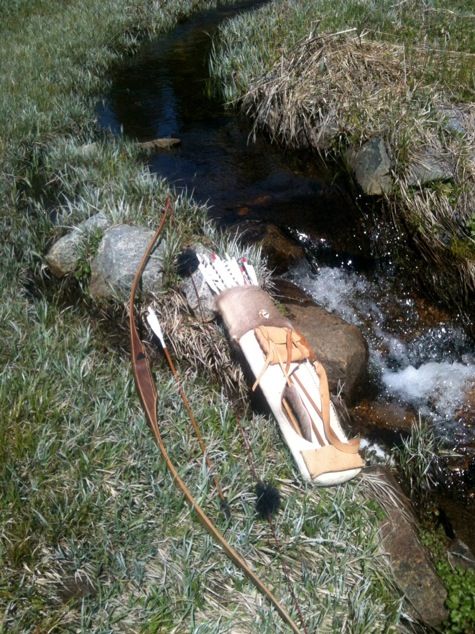

                I am a “build it if I can” type of guy so I tanned a blacktail dear hide with the hair on and made a side quiver that fits my style. The cut in the front hangs down on my right side and I can slip and arrow out with little movement. The quiver can slide around to travel on my back or alongside my pack. If I was to purchase a quiver I would go with Safari Tuff…

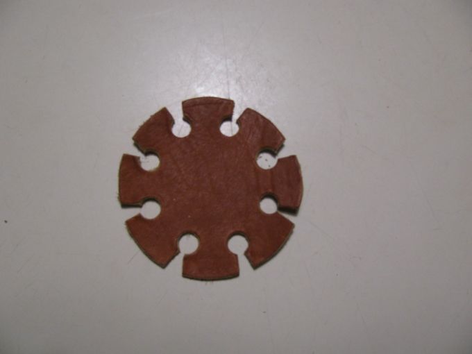

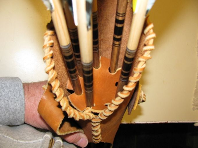

                                  I use this little guy to hold arrows when quiet is needed. The leather is pliable enough that it silently releases when the fletch end pulls through
                                  Honestly when small game hunting I don’t worry about it.
                                    I also put a plug of closed cell foam in the bottom and if you are concerned a broadhead might push through you can put a hard plastic protector between the foam and the leather end cap.

                                          Duncan that little leather disk to hold the shafts is a wonderfull idea! Thanks for the ideas and help! Time to head to the workshop.
