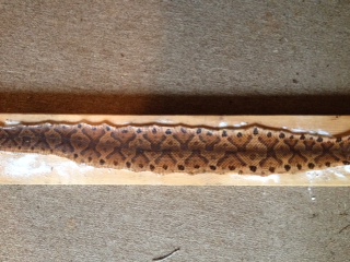

              I take the snake and unzip it right up the belly. Then I peel the skin off the body. After removing any fat that might be on the skin I turn it flesh side up and staple the skin to a piece of plywood. The plywood needs to be atleast 6″ all the way around bigger than the skin.
              After stapling down to the wood apply Borax about a 1/4″ deep.
              Wait 24 hours and remove any dry borax. The wet borax is now history. It’s full of body fluid and fat. Rake the wet stuff into the garbage and again apply 1/4″ of Borax.
              Keep doing this until you no longer get any of the wet Borax. At that point you can now trim the belly skin away and you are left with the back and about half of the side skin.

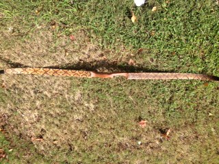

                            Here’s the finished product. Thanks to everybody on here with all the help.
                              Oh baby!!! thats one pretty skin.
                              Hope you can find another to match it.
                              It took me almost a year to find two that matched. One came from N. AL and the other came from L.A. (lower Alabama).:D

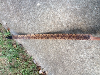

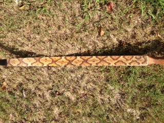

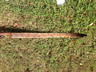

                                          Decided to do the second skin as well. Hell it was pretty dry already and after I soaked it in water, it was just like the first one anyway.
                                          I made a lot of mistakes, but I think it looks pretty good for the first try.

                                            looks great! Good job, sure does make the bow look perty:)
                                              Yep, looks pretty darn good.
                                              Best way to learn is by your mistakes. You never forget that way.
                                                What if the scales are not coming off easily with tape? Should I seal it anyway? I’ve gotten alot of them off but it sure has a lot of texture still that I must assume is scales.
                                                  There are also still some glue bubbles underneath at the curves. Will those harden over the next few days and should I seal the edges with super glue as some people have recommended?
