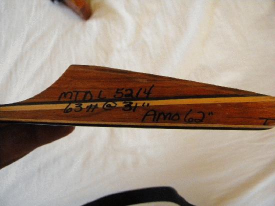

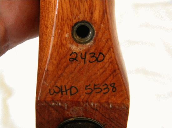

        Found an older bow which I pretty sure is a Martin. But The Limbs don’t seem to fit quite right. This is the first T-D bow I have bought,,right price,,. The riser is marked 2430 buy the stablizer hole,,down by the bottom limb mount is marked WHD5538. The quiver and plunger inserts are brass,, and there are two steel inserts on the belly of the bow,where the limb bolts would pass thru if long enough. Different threads though.(have no idea what these are for) The limbs are marked MTDL 5214 63# @ 31″ “amo 62”. Since there is quite a gap on the ball-bearing side of the mount when the limbs are attached. I am wondering if this is a ‘Frankin-Bow’. I don’t have a problem whittling on the bow to make it fit better, and a refinish job to make it mine. Just need to now about the bow first. And no,, Martin has not called be back.

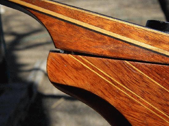

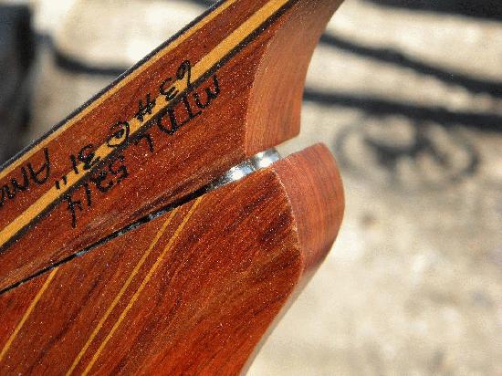

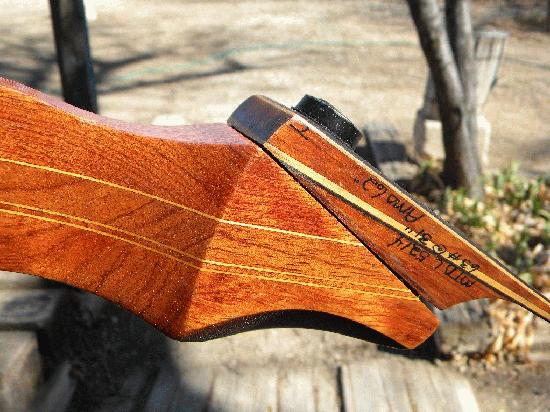

                So here a couple of pictures showing the fit when put together. What do you guys that shoot Take-Downs think?

                    Well,,,Found out that this Riser is from a Martin “WartHog” around 1985 or so,,that is a wheel bow. Some one has put the recurve limbs on it. knew it didn’t fit right. I guess it is called a “Wrafhed” bow. Diffently gonna whittle on this bow.
