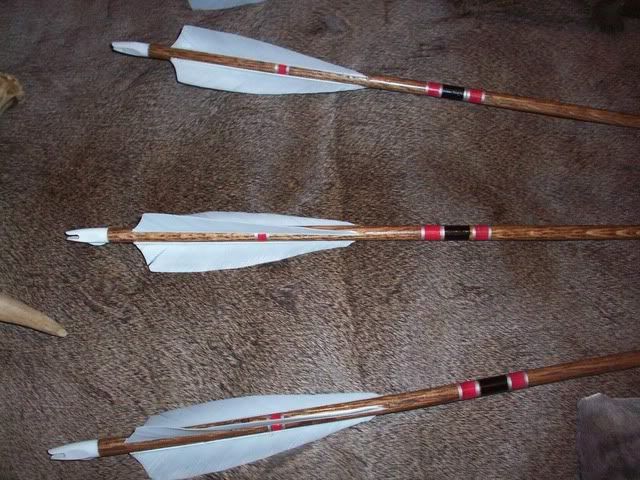

              I found some pics of the 3 red oak shafts I made.
                Those are some mighty fine looking arrows! In fact, I’d say they look Oak K to me 😳
