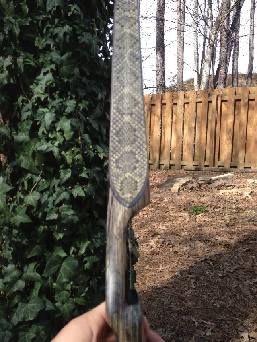

                    Here’s a pic of the riser up closer. The snake skins are amazing too! After trying to do them on my samick, I can’t believe how well done these are.
                      Sorry that came out all pixilated. Here’s a look at the skins.
                        I can tell you that this is by far the sweetest bow I’ve ever put my hands on. When we hunt at Blackbeard Island, you get to hold a lot of trad bows, but I’ve never felt one like this.
                        If somebody stole it today, I’d drop the cash on a new one of the same model immediately.
                        I have a 1960’s Damon Howatt Monterey (hunter) that I thought was about as sweet a shooter as could be made, but I was wrong. Widow’s are worth the money!!
