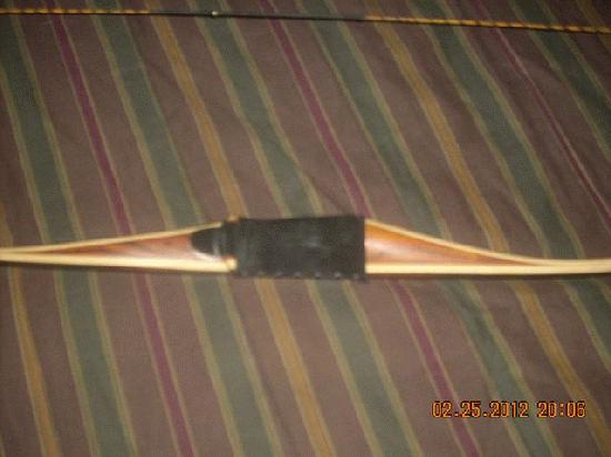

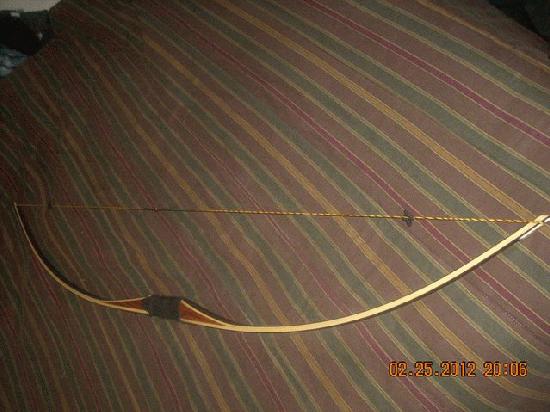

        I Got my new Bama from Nate [Elite Classic longbow with stained bamboo limbs, cocobolo riser with bloodwood accent strip, cocobolo riser overlay, elk stag tips, 75#@26″, right-handed, 64 AMO ]
        I got the bow when i was working in the frozen hell of Deadhorse -45 to -75 for 5 weeks knowing my bow was waiting for Me I got back on 02/1/12 and started shooting it and i love it
        it is fast and a dream to shoot even at 75lbs it shoots 790 grain arrows at 160-162 fps and it doesnt stack it is a Beast and work of art at the same time I love it

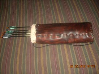

        And then I made myself a Quiet Back Quiver
        I made the Quiver and then took selway 6 arrow grippers [bow quiver] and stiched them in with shock cord and for the pad in the bottom i took sleeping pad foam and rolled it up and pushed in it tight and it works pretty good now i can hunt with a back quiver that wont rattle i can even shake it upside down and theres no noise and the arrows dont move or fall out it can hold 12 arrows in the grippers I took a piece of a broken carbon arrow and cut it to fit then glued in 2 inserts and then made small holes for the shank of the target points to go in and then screwed in the points that was to hold the top open then i used heavy shock cord for straps its a center mount Quiver but with the shock cord you can grab the top and pull it to the side and get the arrow you want [I color coded my feathers so i know what is on the other end]and then it goes back wear it should i also like the shock cord for when you have to put more layers on it still acts the same
        Big Game Small Game and Furbearer Arrows All play nice now and down hit and dull each other

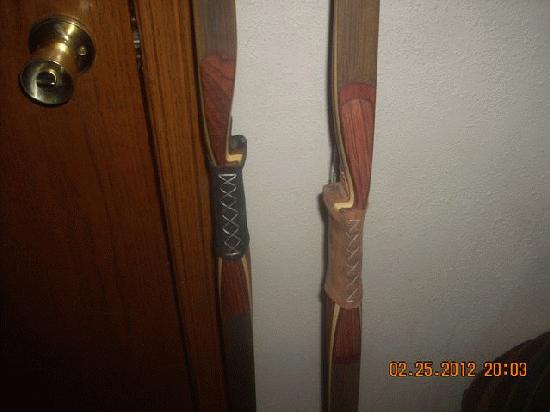

          Cocobola and bloodwood are a great combination my friend. Both of my Bamas have cocobola in them. I’m trying to stay away from it on my next bow but I don’t know if I can!
          Very very sharp bow!!
        • Ripforce
            Post count: 225
            Very nice, I have 4 Bamas love them all! Enjoy
