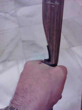

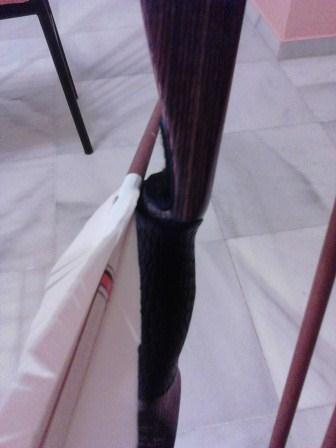

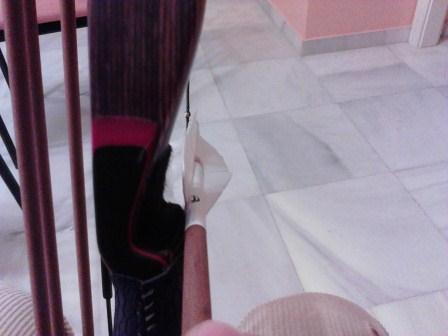

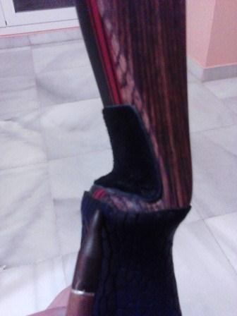

        Hi, I´ve just received my new BW PSR III T/D 60″ 60# @30″.
        I have some problems tunning my arrows.
        I’ve used the bare shaft test, and my CE Heritage 350 has always flight weak, cutted to 31.5″ and 100gr field points.
        I have problems of clearance too. When I’ve shot fletched arrows, hen feather strikes my hand.
        You can see the photos where the arrow is hitting the shelf and my hand.
          You might look at raising the nocking point on the string. Can’t tell from the pictures, but if it is hitting the shelf and your hand, it is probably too low.
