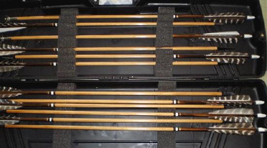

        These are Surewood Doug Fir Shafts crown stained in dark walnut, simple crest w/ testors paint, 4 coats of clear poly, 145 points, and natural turkey feathers that I inherited from an elderly bowhunter now in the happy hunting grounds. The feathers were prepared and cut by me. I hope he is looking down in approval.

          very nice

            Nicely done!
            -Jeremy
          • Homer
              Post count: 110
              Steve — Whatever you do (so far as I know :P) is good by me. I too just made up a dozen Surewoods (got mine from Dave Doran, Archery Past, very straight, super service and good price). Not being a big fan of painted shafts I really like the way you’ve set these off with dark stain behind the minimal cresting. I “footed” mine with 2.5″ sections of aluminum shaft to convert them to screw-ins, which makes them ugly and me be perceived as “unartistic.” And fair enough. But I now have EFOC you’ll never get otherwise with woods, and a broader array of points to choose from. Would be even better if someone marketed alum external footings with a realistic wood-grain pattern (2413 fits 11/32 perfectly) and brass inserts for strength and added weight. But I apologize and don’t mean to pirate your thread … the Surewoods just got me going, which I consider a great improvement over P.O. cedar, for their lightness and strength. May you slay many Bambis with these simple yet handsome arrows. Ho-ho-Homer
                Homer.. thanks. That sounds pretty cool. Definitely gets your arrow where you want them to be. Which I think is why we make our own in the first place. That way we KNOW what we got.. we made them ourselves. Good going!

                      Very nice Steve!

                          Those are flat out gorgeous!

                                SteveMcD wrote: These are Surewood Doug Fir Shafts crown stained in dark walnut, simple crest w/ testors paint, 4 coats of clear poly, 145 points, and natural turkey feathers that I inherited from an elderly bowhunter now in the happy hunting grounds. The feathers were prepared and cut by me. I hope he is looking down in approval.
                                Great looking arrows , Steve . GOOD JOB !! Next time you post them , lets’ see some blood .
                                  My God, Steve, you are such an artist! These are my favorites of all the ones I’ve seen online or in your quiver! I think I will order a dozen of shafts from Cedarsmith of Colorado and make arrows for the upcoming season.

                                    Those are fine looking arrows. I love natural color turkey feathers. Looks great with the dark stain. Beautiful.
