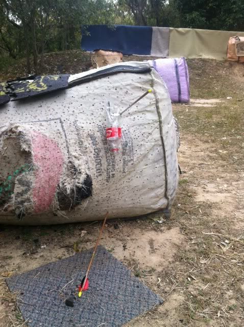

                                Etter, I did a little experiment the day I was out there shooting that whopper of an arrow. Once I had more or less figured out my ‘gap’ for that shaft, I shot the unfletched arrow using gap aiming at 20m. Then I moved a few metres to the left (so as to avoid any unconcious reference to the POA I just used) and shot an identical, fletched arrow instinctively (noting that my ‘instincts’ are not at all tuned to this bow/arrow combo).
                                My ‘bullseye’ in this shot is the white disc (the insert from a gatorade bottle cap) stuck on the coke bottle just left of the unfletched shaft.
                                Obviously instinctive shooting is going to require a lot more practice to have confidence, but if you gap, it’s just a matter of finding your point of aim at a few different distances and then an accurate judge of distance. With a bow/arrow combo like this you’d obviously need shorter intervals between your known Points of Aim. But I agree, for this little bow I’d be more comfortable with a lighter gpi setup that delivers a bit flatter trajectory πŸ™‚
