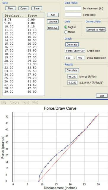

            Here’s the FD curve drawn to 29″
