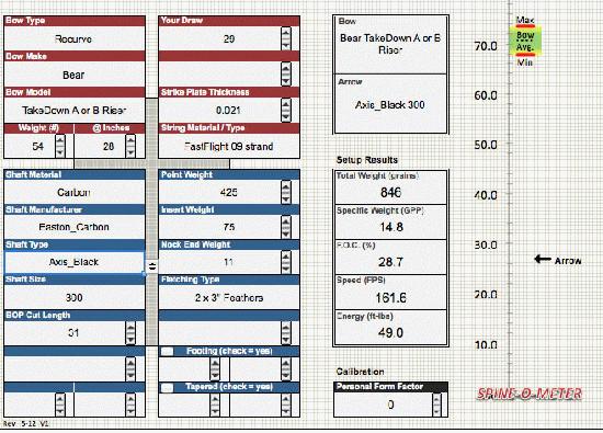

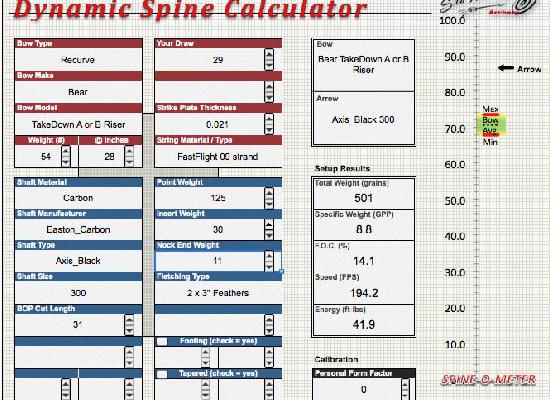

          You could run the numbers through Stu Millers calculator. I did a quick look and came up with a 30 f/s difference in speed. See attached images.

            Here is the high FOC calcs.
              I think you have a superb setup for elk, moose, big bears, etc., but you’re over-arrowed for those little guys. I would consider dropping back to around 650 total weight, as much as possible up front. A real easy fix, or starting point, is to drop to a 225 TH or a 190 Meathead and reduce the weight of the screw-in adapter while you’re at it. I think you can get steel adapters down to at least 75 if not less. While there is no such thing as overkill with arrows, as Ed likes to remind us, there is such a thing as over-arrowing for smaller big game when it unnecessarily slows you down to the point you may miss shots due to jumpy speedy critters. On the other hand, I tried reducing arrow weight for the little AZ Coues whitetails and practiced with the lighter arrows all summer. Yet when the shot ops came I consistently shot over. So I reverted to one bow and one arrow for everything, since I don’t seem at all adaptable. But others are so it’s a personal thing.
