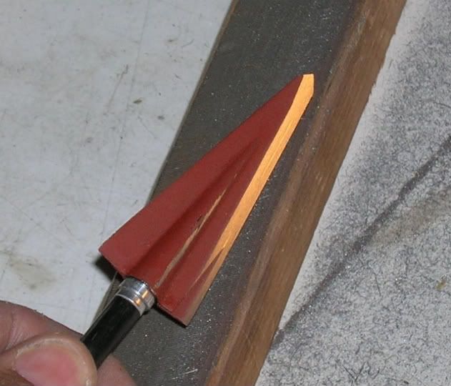

        When I switched to Grizzlys about 10 years ago, I was not use to single bevels, and it was hard to get a good edge, I have sense perfected my sharpening to have a true single bevel razor’s edge .
        You can see the new bevel on this one.

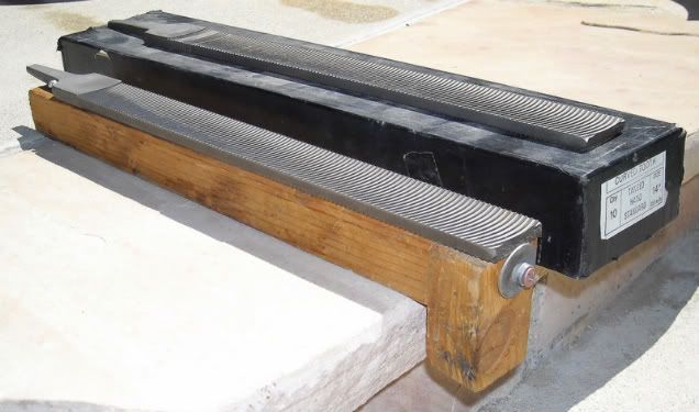

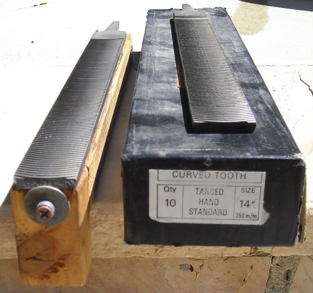

        #1 You must use a great file, when I first started to try and sharpen the Grizzly, I was using the same file I used for my Zwickey and I had a really hard time getting the new bevel to get all the way to the flat side, it took forever.
        I mount my file to a board so it wont move and I can keep a consistent angle.

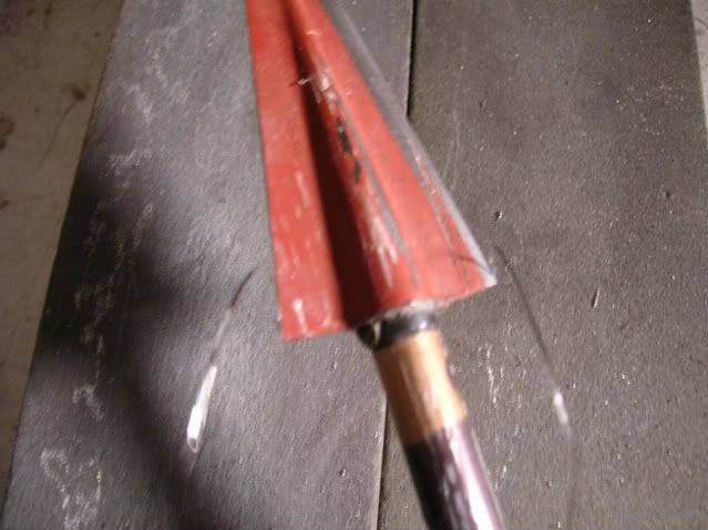

        #5 Now I go to my leather strop, this will cause the wire to jump off of the head, ( some times there will be spots that don’t want to come off, just go back to your fine stone and do some more polishing, then back to the strop )you can see the wire is just barely hanging on, a few more strokes on the strop and it’s there.
