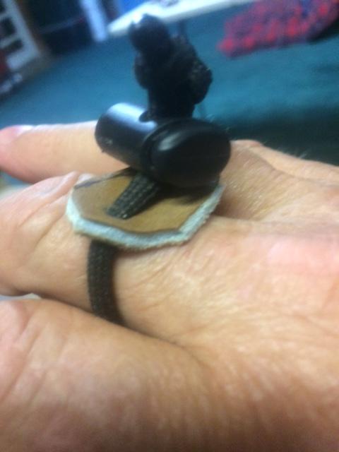

                            Another little trick, another tab, the little tab thingy…fits over the back of your finger and sure can ease the pressure on the bone.

                              Like this…………..

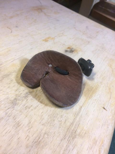

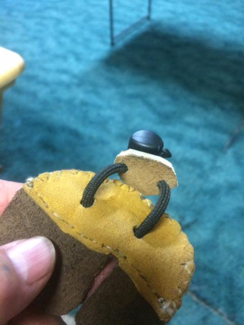

                                  Looking at R2s custom tab design, I was thinking that might be just the ticket for real cold weather work. Ie the adjustable string tightener would allow it to be used ( and stay put ) over a heavier winter glove.  What say you Ralph – have you tested it in panhandle winter extremes ?

                                              You’re welcome. I feel compelled to note that I haven’t been smart enough until this very moment to realize that swapping in a slightly longer cord than the original will facilitate using an even thicker glove. The older I get, my brain seems much more susceptible to … what were we talking about ???
                                              Charles
                                              I understand your situation very well, I have the same affliction. The revelation for me was seeing R2s longer adjustable cord, on his home built custom made tab – thanks Ralph.
