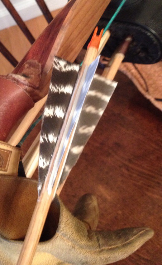

                                        Here’s my final end product.2 12″x 4 straight fletch;slight offset.Had too build out the shelf plate when I switched to a smaller feather.I have finally divorced my magnus stinger 2 blades and beer can arrows(said goodbye too aluminum inserts as well).I must confess though, I did take some of the old dogs to the pope and young trad shoot in brownsville.(broadhead 3d shoot).Shot the tuffheads only at targets that if I missed could easily recover my arrows.Thanks to all for showing me the light! THESE ARROWS ROCK!
