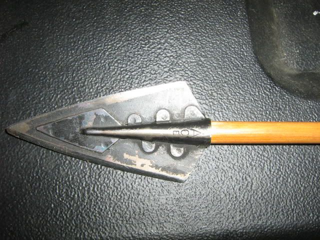

Want to see something that will raise a few eyebrows?
One of these ace heads on one of these skinny shafts…kinda reminds me of some pygmy spear Elmer Fudd was dodging in one of the cartoons. 😆
A Goshawk on them is :shock::shock::shock: !
God Bless
That’s a beauty. I’d love to go to wood, but for reasons of simplicity for now I’m going to try, try, to keep it simple. That’ll mean these aluminum shafts for now. Keep em coming! dwc
