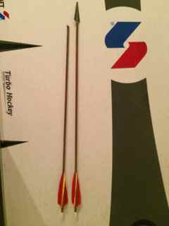

        Hello all – First let me say I had a wonderful 10 day elk hunt with a long time friend. Plenty of action, he was able to harvest a 5 point with his compound. Wonderful days spent stalking in the mountains.
        However I want to start a discussion on my set up, shot choice, bad penetration, and failure to recover a bull I arrowed! I am having trouble reflecting positively on my hunt with the bad after taste of a unrecovered/wounded animal.
        I shoot a Saxon Hawk recurve, 50# @ 28. I ‘m probably pulling closer to 53#. Arrows are Trad only carbons, with a Tuffhead 300 grain broad head, weighing 650 grains. FOC about 15%.
        I took a cow with this set up three season ago at about 15yds. Penetrated to the offside ribs.
        This season I took a shoot at a spike bull @ 27yds, broadside looking towards my buddy cow calling down the ridge but not alert to me. He jumped the string a bit but I did see my arrow connect mid rib cage a bit farther back than ideal. Here is a pic of the recovered arrow. Waited about a hour to trail the bull. Found the arrow broke off about a half inch behind the broadhead. Good blood trail with foamy blood indicating a lung hit. The blood trail went uninterrupted for about 100 yards with the bull stopping three times bleeding puddles. At the last puddle the blood trail ended – searched two days but unable to find him. Needless to say the situation weighs heavy on my mind.
        Am I shooting too light a set up for elk? Was the shot too far? Do my tracking skills suck. Can I learn my lesson fully enough that it puts some poor value on the wounding of that bull, and ensures I’m better hunter next time?

          Right off the bat, increase that FOC. I can’t see how you’re only 15% FOC with a 300 grain head, though.
        • manystalksfewkills
            Post count: 6
            Not sure exactly how high the hit was. Seemed a bit high and back but still in the “kill zone”
            I may not be figuring my FOC correctly. 32″ from nock to broad head point. 9 and 1/4″ point to balance point.
              ATA method for measuring FOC is from the throat of the nock to the back of the point. You’re basically just measuring the shaft, not the broadhead. Your FOC should be low to mid 20s.

                I am not sure what breaking right behind the broad head is indicating particularly with a carbon arrow. You did not say how much blood was on the arrow indicating depth of penetration. You saw the arrow hit …what was you recollection of how much arrow went in.?? It sounds like you got part of a lung but maybe hit bone some where before you got there. STUFF HAPPENS ….very frustrating.
                Others might have more insight.
                Your total arrow weight is slightly on the low side to breech bone while it is 650 that is close to the minimum but those figures are ball park figures some bone may require more.…..Just thinking out loud.
                The AMO method of measuring the FOC does not include the broad head or tip. While it is a exceptable method it is hard to relate back to Ashby’s foc guide lines
                Try using this formula
                http://tuffhead.com/education/formulas_FOC.html
                measure your arrow length from knock to inert. Balance point from knock to balance point and plug those in the formuls.
                Not sure you are calculating it correctly.

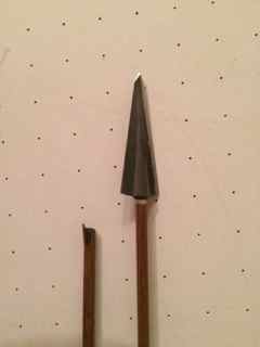

                      Vintage Archer,
                      There is blood down the shaft about 7″. I did not see the arrow well after the hit so am not sure if that indicates penetration or just residual blood. Thanks for the info on arrow weight.

                          Manystalkfewkills ..from your description of the arrow there was not much penetration . Seven inches of blood is probably about five inches of actual penetration beyond skin,tissue and fat.
                          Any thing is possible but there is a chance you hit higher on the body than thought .Six inches below the top of the back would put the arrow in the top ribs/lower spine. You could have got bone and top of one lung. A hard impact will break a arrow like you describe. A high lung shot would give up blood but subside until the lung fills. Any way it is all supposition now.
                          Using the FOC calculator at the link above I plugged in these numbers from your arrow.
                          1, arrow including tip less 3″ for the broad head makes arrow length 29 inches .
                          2. length of arrow to balance point = 22.75
                          FOC of your arrow is around 28.5 apron. If I used the right guessed dimensions
                          You did not give particulars of what components made up your arrow but it is possible if the arrow spine will handle it you could up your total arrow weight 50 grains and increase foc to approximately 30 %. A 3 inch footing would add 25 grains.:D

                              With the arrow broken behind the broadhead, and not much blood on the arrow, I tend to think it was a backstrap hit myself.
