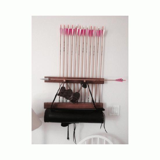

        I’m in the process of making a new elk arrow setup.so far I’m using a gt 7595 traditional,100 gr.brass insert,300 gr.field point,1″1/2 2213 aluminum footing,30″3/8 length, 4 x a/a 21/2″ fletching 75×105 degree.Total weight 777 grains.Shafts are still a little on the weak side but getting real close.Down to making 1/32 cuts.Is it just me but the closer I get the more I’m getting nervous about going to far.Moving at a snail’s pace ,this is my third day of tuning.Had about thirty head of Roosevelt’s across the property yesterday.Nothing like a little inspiration to keep it going. Going to ditch the screw in adapters and use the glue-in/glue-on brass adapters for my Tuffheads.I will measure the foc when I finish with the tuning process.A big thanks to Dr.Ed for all you do!…Cheers!!

          SKINNER congratulations ……it sounds like you are on the way to a excellent arrow ,
          I know it takes a lot of time/work/fun to get these results.NICE JOB 😀

            It is gnarly… I numbered them once I stepped back to be sure any “fliers” were the arrow and not me and kept a chart to make sure the same shafts were mis-behaving.
            One friend teased me that I named the danged things… and have a funeral if I loose one..almost… shaft, inserts, heads… all get pricey but the time is the killer when one goes awol!
