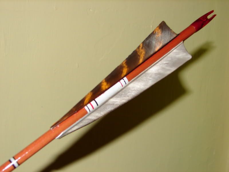

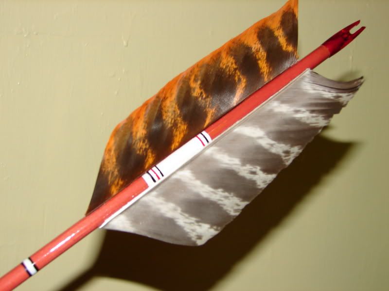

        For those of you who process your own feathers for fletching here is an easy method of adding color to them.
        I Found a How-To on the net about dying feathers with Kool-Aid and decided to try it. Works pretty good.
        Here is the link
        http://www.ronnlucassr.com/docs/Dying%20Feathers%20101.pdf
        My daughter commented on the similarity of it and dying Easter eggs since you add vinegar to the solution. That helps set the colors a bit. After they dry there was no color transfer to my hands when I picked them up.
        So far I have made green and orange and the color transfer is very good. I have soaked them with water to see if the colors would run afterwards and they are colorfast.

                Orange looks good too.
