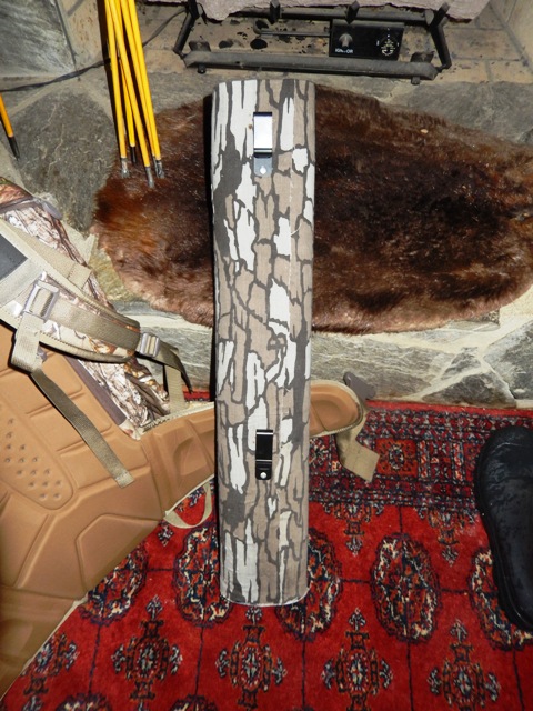

                                As requested…
                                The body is made from 4″ PVC drain pipe. It’s thin walled, and I had it laying around. I cut it to the longest length I could fit in the oven. Waited till the wife was gone, and stuck it in at 200 deg. After about 5 minutes it was soft. I took it out and laid it on a board. It took an oval shape of it’s own accord.
                                The bottom is just a piece of 3/8 plywood glued in. I plan on putting some foam on top of that.
                                I lined the quiver with the leg of my daughters old jeans. The outside is covered with some Mossy Oak cloth that our own Duncan generously gave to me several years ago. I’ve been hording the cloth till a worthy project came along. Thanks Duncan!!

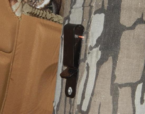

                                The clips are pop rived on. I added a washer under the rivet on the inside to make sure it didn’t pull out. I also added a “stay” at the top of the clip to keep it from rotating. I couldn’t find any clips that had 2 holes in them. And I don’t have the tooling to drill into spring steel. so I just bent some #12 copper wire into a staple shape and wrapped it around the top of the clip. I soldered the two ends together.
                                The clips are positioned to take advantage of some straps on my backpack.
