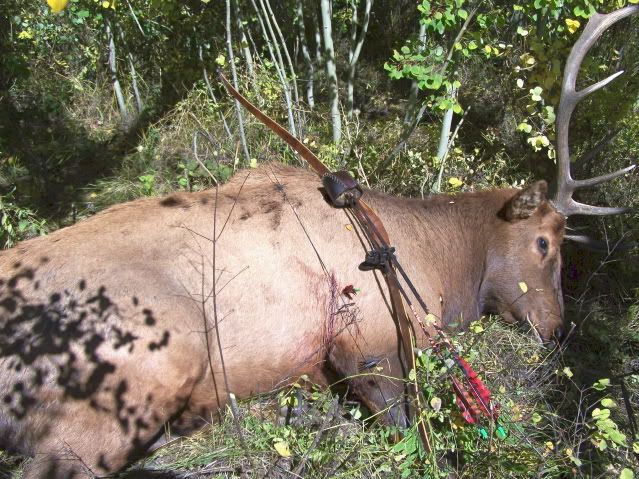

        I shot this bull, above, from just 6′ as he whirled to run when I drew. Setup was Carbon Express shaft with Abowyer Brown Bear head, brass shaft insert and steel broadhead adapter, total weight 680 grains with 26%+ FoC. Bow is Shrew Classic Hunter, 55# at 28″. Arrow struck midchest and got only about 8″ penetration — a combo of “whirling effect” of the bull at impact and mostly, a rushed snap shot that was well short of full draw. (I swear, no matter how I try to get it right and beat myself up when I don’t, I will always be susceptible to “buck fever” judgment errors like this, given proper pressures — like a bull standing right over you on the last day of the season!) Arrow flopped several times as bull ran off, then the insert pulled out of the shaft and the arrow fell out leaving head and insert inside the lung. This next photo shows what that combo — shaft flopping around and head staying in — did to the lung. Neither my hunting pal T. Downing nor I have ever seen anything like it before, with rifle or bow, looked like a blob of lumpy Jello. While the bull didn’t lead a drop of blood externally, his chest cavity was full of it. “You could drown in that amount of blood,” as my observation. Note also the small knife. According to Murphy’s law I’d forgotten my belt and belt knife that morning and had to do the entire job with this little Helle. 3.5″ blade is fine but the tiny handle left my hands cramped.
        Here’s the entrance hole made by the Brown Bear — huge, with a blown-apart rib strike. (I couldn’t find the head in the bloody mess and need to return to the scene once the scavengers are done to find it. I expect no tip damage.)

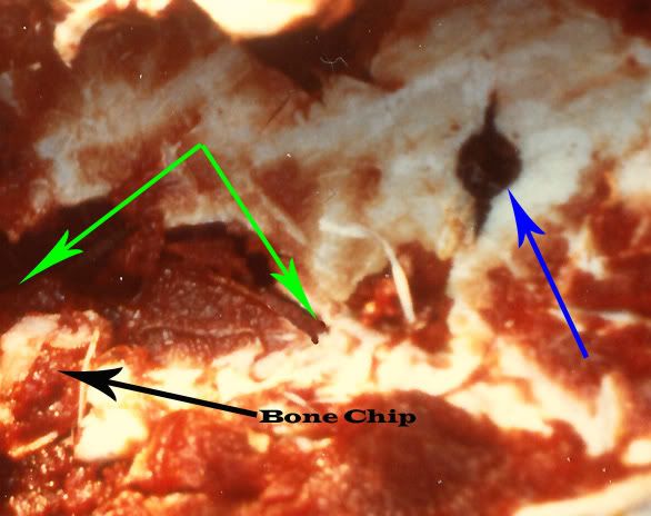

                                That ‘hole’ in the scapular flat is precisely typical. Splits from hits in the ‘flat’ are rare; they come from hits neat the scapular head. Here are a couple more. Note the extreme similarity of hole size. No shaft drag there!
                                First pic is zebra scapula. Note single-bevel ‘hole’ (green arrow), bone chip (black arrow) made by 190 Grizzly and hole left by double-bevel Howard Hill BH (blue arrow).
                                Second pic is from David Messiaen’s Mouflon; another 190 Grizzly.
                                Consistency of performance on the scapular flat.
