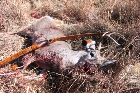

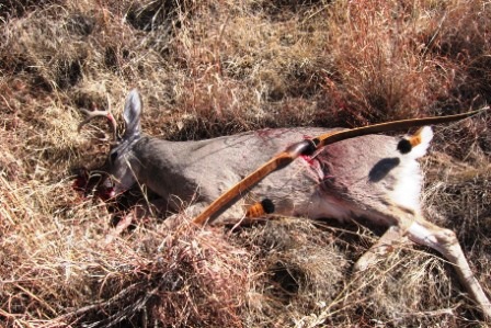

        I am posting this thread not to boast on my recent kill of a nice Coues (Sonoran Desert whitetail) buck (in fact, what follows is more of a confession than a boast), but rather in hopes of opening a few more eyes to the phenominal killing power of a proper “Ashby” arrow set-up, esp. when things don’t go perfectly.

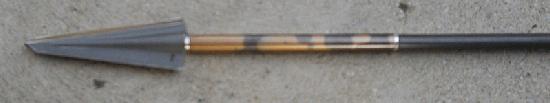

        Gear: 53# & 28″ Shrew Classic Hunter (short longbow)
        Arrow: CE-250, 29.5″, total weight6 711 grains with 100 grain insert and 125-grain adapter in a 147-grain STOS head custom-ground from a blank as a left single-bevel by Sharpster at KME. FOC is 24.58%.
        See photos below. There were two shots. First was steep downhill, 15’ up a tree and 15 yards. I shot high (still trying to get the knack of shooting steep downhill, as tree stands are fairly new to me) and hit the buck’s left backstrap. The broadhead clipped the bottom of the spine, which put the buck down almost in its tracks, then deflected downward through the top of the left lung but didn’t get enough penetration after the bone strike to keep going; about half-shaft penetration. The tanto tip of the head was slightly dulled, and a very small nick in the edge of one blade. No matter, as before I could get down out of the tree to finish the buck off with a second shot (I absolutely hate spine hits and would never take one intentionally), he had quit struggling and appeared dead. But to be certain, and to add a bit more infor to Ashby’s data, I took a second shot from the ground, also about 15 yards and from a rearward angle. That one entered the rear left lung (top photo) and tore a horrificly large entry wound, then angled on through the front of the right lung and sliced off the thin tip of shoulder blade. I think it would have kept going for a full pass-through but the ground stopped the head as soon as it punched out the right shoulder. (see photo in next post) The buck blew a tremendous amount of blood from nose and mouth at the first shot, and the body cavity was flooded with an enormous amount of blood, just as were the two bull elk I’ve recently killed with single-bevels. I have never seen internal bleeding like this with any sort of double-edge head no matter the number of blades.
        Fingers crossed that Dr. Ashby will jump in here and explain the large entry wound and anything else there may be to learn from this bloody mess but near-instant kill, which in turn will precipitate a good conversation about single-bevels, arrow weight, blood trails, etc., as it’s been a long while now.
        I just finished cutting and wrapping the meat, which is as good or better than elk, and have the head in the freezer until I can clean and boil it for a skull mount.
          Here’s the other side …

            Congratulations Dave. That’s a great Coues deer. Sounds like you found one of those non-existent heavy bones in a deer’s body. Lots of folks maintain you don’t need an arrow designed to penetrate heavy bone when hunting “light big game”, because they don’t have any heavy bones.
            You must have hit the spine fairly solidly to drop him in his tracks. Did you examine the vertebra to see if it was fractured? From what you describe I suspect it might have been. A glancing blow on the spine with no more force than an arrow carries, likely would not have dropped him in his tracks, particularly if the impact was not at a right angle to the spine. Or, perhaps, I’m misinterpreting your description and the shot was fully broadside.
            Regardless of the shot angle, deflecting off a bone, with the arrow’s path being severely redirected, always robs you of a lot of penetration, but you clearly still had ‘enough’; and that’s precisely the reason for using a penetration enhanced arrow setup; something with far more penetration needed for those all too rare ‘perfectly placed’ shots. Half-a-shaft penetration on an arrow of that length is pretty good after hitting the spine.
            That gaping entry wound that you note on your second shot occurs commonly when a single-bevel broadhead enters at an extreme angle to the surface of the tissues. It creates an elongated cut; a ‘slashing wound’, if you prefer; which is opened wide the other direction because of the broadhead’s rotation. You won’t often see this type of cut unless your single-bevel broadhead is truly sharp.
            You did a pretty good job of hiding the blood in the photos, but the amount of blood still visible on his nose and chest, as well as on the grass, give a pretty good indication of what it was like. The huge amount of internal bleeding you have been noting; the ‘flooding” of the thorax with blood; is a routine feature of a thorax hit with a truly sharp single-bevel broadhead. Just as with the large, gaping entry wound, you won’t see that massive hemorrhaging unless you have that broadhead truly sharp. When those single-bevel heads are really sharp there’s often a large amount of blood-shot tissue along the entire arrow’s path. It’s frequently so pronounced that it truly does look, for all the world, like a high-velocity gun shot wound.
            One gets the bone splits even when the broadhead is less than truly sharp, so lots of folks have noted them, but not as many folks have noted the massive soft tissue damage. I’ve been trying to tell folks for a long, long time about the advantages of the single-bevel BH’s in soft tissues – when the broadhead is truly sharp. The soft tissue damage they cause really does have to be seen before one can appreciate that a broadhead, of any type, can cause it.
            Unfortunately there are a lot of bowhunters who have used single-bevels that were not truly sharp, and they (truthfully) are quick to say they don’t see much difference in either the soft tissue damage or hemorrhaging between them and a double-bevel broadhead.
            I’ve had tons of folks ask me what I considered to be a truly sharp broadhead. In the past I was sometimes fortunate enough to have one at hand to show them, but usually I didn’t. Nowadays it is easier. When anyone ask me what a truly sharp broadhead is I just tell them to get one from Ron (AKA Sharpster) and check it out. That’s what a truly sharp broadhead is.

                          Right now my best is a Tuffhead 300gn with a 100gn steel adaptor, 4″ of 2117 over a 300 Goldtip 29″ long with 4×2″ A&A fletch, it has a 35.07% EFOC for a total arrow weight of 740 grains, out of a 60lb longbow.
                          Why single bevel? 1st it’s SHARPER, period. no if’s, and’s or but’s about it, as Ricky Bobby said: it’s science lol
                          2nd it pops or splits bone easier, allowing the broadhead to keep penetrating deeper into the vitals or creating an exit.

                              King I am always impressed with that arrow setup. If at all possible could you show a close up of the external footing? I assume that you are shooting off the shelf, does that footing interfere with the process durring the draw cycle? Just curious on how you delt with the transition from carbon to aluminum.
                              Bill
                            • kingwouldbe
                                Post count: 244
                                Hi Rogue,
                                Yes, I do shoot off the shelf, and no, I don’t even notice when the arrow steps up, I chuck up the aluminum shaft in my hand drill and spin it on a file, so the transition is vary smooth.
                                Hi Dave,
                                No, I use the aluminum inserts, only because I’m to cheep to buy those brass inserts, if I want more weight I use a brass screw in the back of the insert ( 4 for a dollar ) or I use an internal footing.
                                I might try the brass some day, I know they are a lot stronger, it’s funny the evolution of my arrows, I have been all the way up to 1050 grains ( if I was shooting out of a tree stand I would use them, as your shot distance is way more predictable ) they make my bow dead quit and pack a big punch.
                                I like moving the weight to the front with a high EFOC and yet not shooting a telephone pole, as 90 +% of my hunting is spot and stock or still hunting, and I never know how far my shot will be, most are under 20yds, but some are longer.

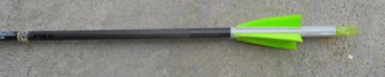

                                  can you tell us a little about the fletching you are using?
                                • kingwouldbe
                                    Post count: 244
                                    jgilmer wrote: hi king
                                    Jgilmer, this should help you, it’s all about them.
                                    http://www.tradbow.com/members/cfmbb/messages.cfm?threadid=C8EA4FBD-1422-1DE9-ED1A1C909376B7B6

                                            The farther back you can mount the feather the less fletching you’ll need (and the higher FOC you will achieve). That’s because mounting them farther back gives a longer steering arm for the fletching. Thus, it takes less fletching surface area to exert the same amount of steering pressure on the shaft’s rear. I mount mine as far back as I can and still have clearance for my shooting glove. I have friends using these with mechanical releases, and they set them virtually touching the nock. The can stabalize the 190 Grizzly, Brown Bear and Ashby BH with three 2″ fletches, even a compound speeds, under all wind conditions.
                                            With my poor finger release I use 4 fletch, each 2.5″ long. With a really clean release one can use less. However, when determining how much fletching you need you’ll need to check a couple of things. First, be sure to check the flight of your arrow (with broadhead) in all wind conditions; cross wind, quartering wind, into the wind and with a trailing wind; to be certain that you have enough to overcome any windsheer effect of the broadhead. Second, shoot them enough to be sure there’s sufficient fletching for stable flight when you get one of those extra-poor finger release.

                                                  Ed — As an experiment, could I cut the front inch or so off some 5″ feathers already on arrows to see how little I can get away with and still have perfect flight? Or is the shape of the A&A, straight-back etc., an essential part of the formula? I shoot almost exclusively broadheads that are long and narrow, like the Tuffhead, so should need minimal feather pressure to counteract minimal wind-drift. My fletchings are pretty standard with mild offset and no helical. Thanks, dave
                                                • Ed Ashby
                                                    Post count: 817
                                                    Yes, you would want to remove the forward part of the fletching then trim the remaining portion to a straight slope.
                                                    Troy makes his by cutting the front section off larger pre-cut fletching, by making a vertical cut at the rear. Apparently Troy has a HUGE supply of pre-cut feathers. I cut mine from full length feathers, and get several from one feather (cheap to make!).
                                                    The straight-back portion of the A&A pattern IS there for a purpose: it creates the least turbulence at the fletching’s rear (or so O.L. tells me, and he the aeronautics expert) which he says results in the least ‘noise’ in flight; and, as usual, I think he’s right. We tried small fletching with different cuts and the straight-cut trailing edge did sound quieter in flight. Regardless, just shortening the feathers and reducing the size and height of the fletching will reduce the amount of offset and helical surface; if you have offset and helical on the existing fletching; which will lower the sound level.
                                                    You are right about the BH’s you shoot; they have very low windsheer effect, so require less fletching.
                                                    As an aside, and something few consider: the TRUE FOC of an arrow depends on the location of the CENTER OF PRESSURE exerted on the arrow in flight. It’s likely that, if you use a lot of fletching the fletching may be lowering the TRUE FOC significantly, by shifting the Center of Pressur farther back along the shaft in flight.
                                                      [quote=Dr. Ed Ashby]Yes, you would want to remove the forward part of the fletching then trim the remaining portion to a straight slope.
                                                      Hehehehehehehe!!!! If he only knew how many feathers I still have. It’s one of the drawbacks/advantages of having been in the archery business….:D
                                                      As a matter of fact I can take a 5″ feather and get two 2+” feathers.
