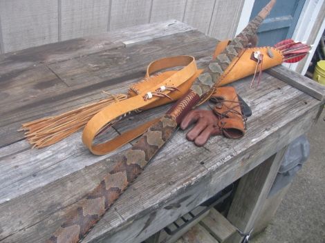

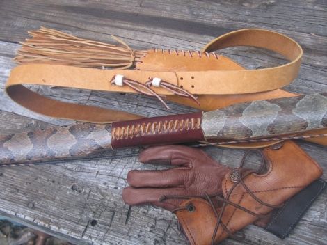

        This is a bow I made year before last but was never really happy with the finish or the tiller or the finished weight. So I finally got time to go after it with the rasp and scraper. In the mean time a couple of copperheads wandered into my yard and I made skins out of them. So I got the tiller fixed and dropped weight a bit and refinished it topping it off with the copperheads. It finally quit raining but it is so humid here I actually had to wipe the camera lense between shots. So, without further adieu I introduce you to “Askook”.
          Duncan, that looks fantastic. What did the weight come down to? Only hope mine turns out half as well. What’d you use over those skins?
            Tailfeather,
            I have not put it on the scale yet but I did get to shoot it some before the monsoon arrived. It feels like upper 40’s maybe 50. I want to build some new arrows for it so I will scale it to see where it is before I build anything. It was shooting some old 11/32″ cedars with bananna fletch and I think they were 45-50 spined with 125 gr field tips. They shot good out of it. But then that is my favorite arrow for most of my selfbows.
            I use polyurethane as finish and I wipe it on with a cloth. Once I have several coats on it and it is dried hard it can be buffed with steel wool to take some of the sheen off. I still need to do that.
            Duncan

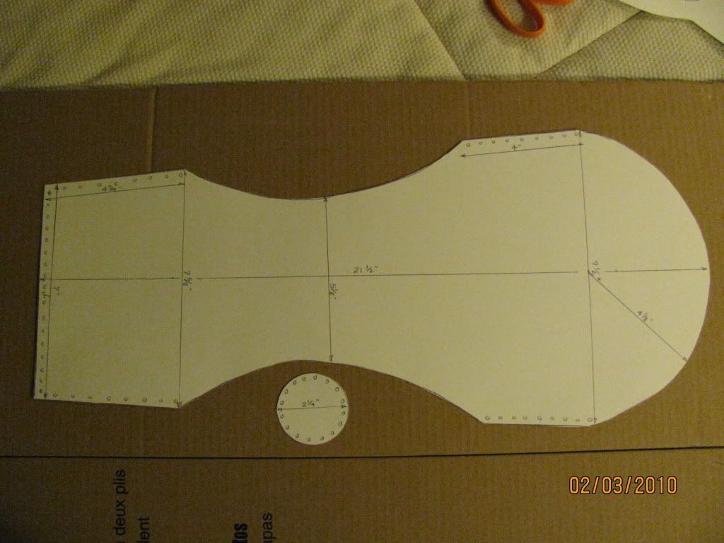

                        Ausjim and Bruc, thanks, I did make the quiver it is my take on the sidestalker, it is my go to quiver of this type for stumping and general practice. I have posted a drawing here before and I can post it again if you want to make yourself one.
                          Duncan wrote: I have posted a drawing here before and I can post it again if you want to make yourself one.
                          Please do πŸ˜€

                                ausjim wrote: [quote=Duncan]I have posted a drawing here before and I can post it again if you want to make yourself one.
                                Please do πŸ˜€
                                Here is a pic of the pattern. You may be able see the dimensions well enough to re-create it on some light poster board. If you don’t feel comfortable with that I could mail you a pattern but I would need your address. Another solution might be to make a PDF file of it at a specific paper scale. I have access to a large scanner. Then you could load the PDF into a thumbdrive and take it to your local print shop and have them print it off at the specified paper scale. For example: 22″ x 34″ ANSI. Probably metric down under for Ausjim.

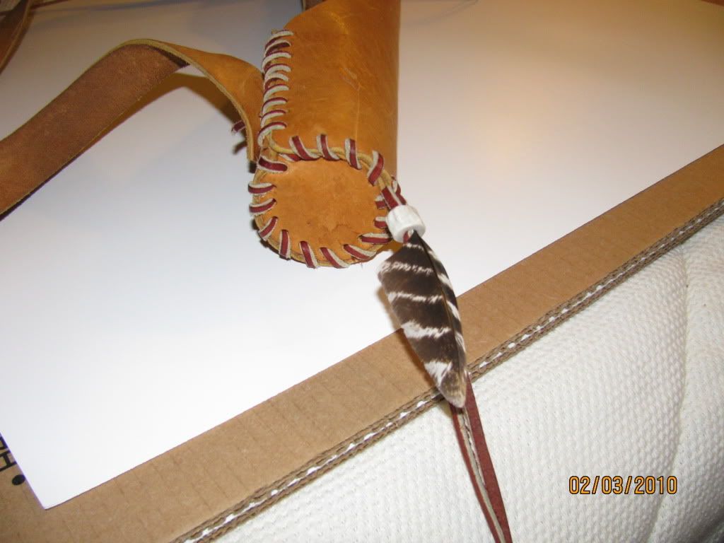

                                Some pics of the stitching. Just simple rawhide strips.

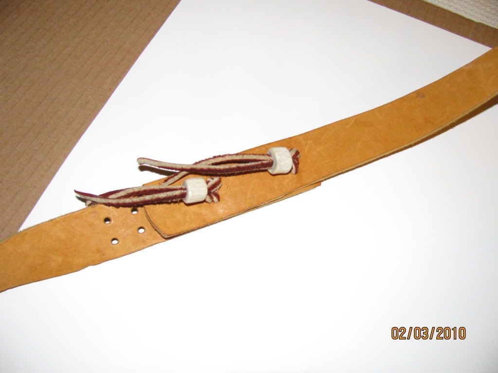

                                I used a spike buck antler to make my beads for decoration.

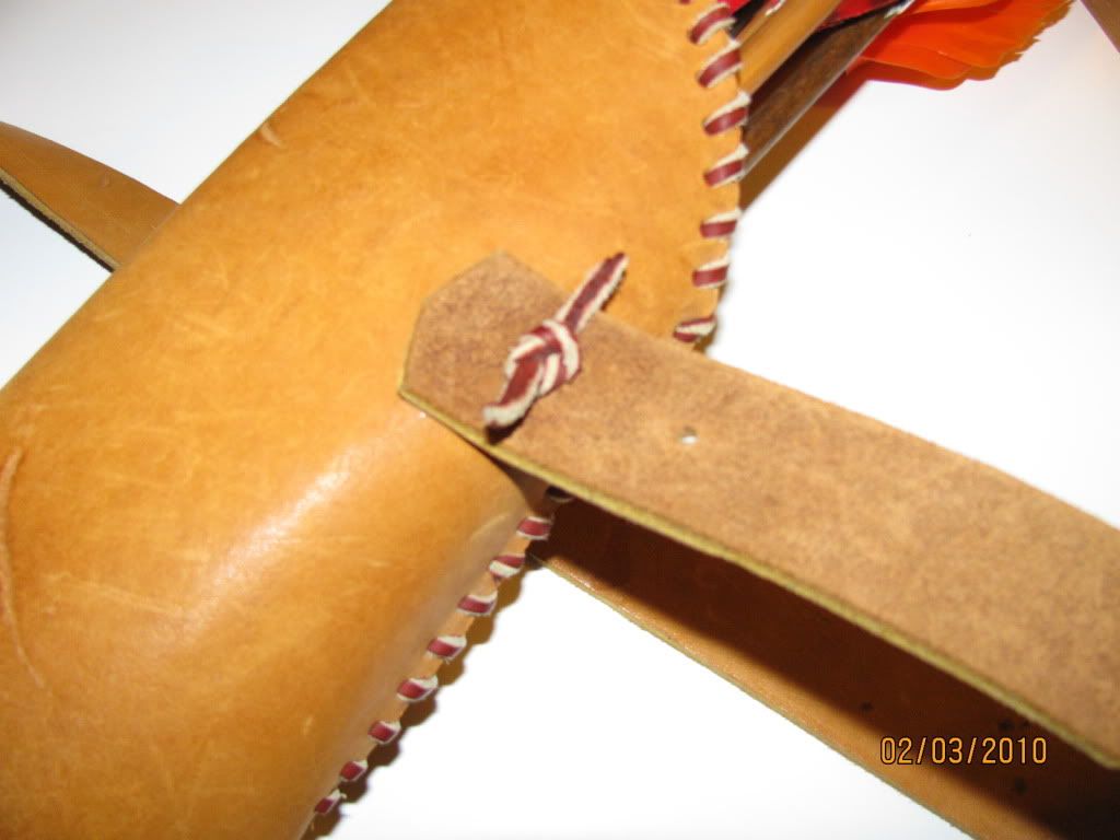

                                Note the heavy weight of the leather, Light weight leather won’t work.
                                I put a piece of closed cell foam in the bottom to protect the end cap.
                                  Duncan, that’s great mate. I was able to save the higher res pic from your photobucket and can zoom in to see the measurements. Thank you very much πŸ˜‰
                                    Absolutely gorgeous work, Duncan, on bow and quiver. Where do you buy that heavy leather? I’m about to make a knife sheath and will need a square foot or less of heavy leather and haven’t a clue where to look. You got those skins on so smooth and flat that they look like, in that respect, fake tape skins … which I trust you understand is a complement! πŸ˜€
                                      Thanks Dave but copperheads just make any old bow look good. πŸ˜€ About the leather, I got that leather off of a website about 10 yrs ago. I can’t remember the name of it but they sold upholstery remnants and it came in a 50 lb bale of various thicknesses and colors. The cost was about 90 bucks with shipping. I have used up all the good thick pieces making quivers, knife sheaths, and bow handles. I figure it was worth it because 1 comparable quiver would have cost more than 90 bucks and I got 5 good quiver projects out of the batch. I still have some small scraps left. Its nice to have some leather scraps around when you need some.

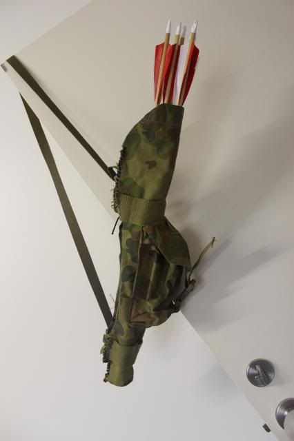

                                          Dunc, I didn’t have any decent leather scraps lying about, but as always I had plenty of scraps from work, so I knocked one up last night from what used to be an old field pack. Proof of concept, huzzah!
                                          Now I just need to buy some leather scraps and make one that isn’t ugly πŸ˜‰ Incidentally I put an adjustable shoulder strap on this one and it changes quickly and easily from a side quiver to a serviceable back quiver too. Thanks again for sharing it πŸ˜€

                                            Innovation ain’t always ugly, simply making use of what ya got and goin for it. πŸ˜€ Now if you’d make one we could see!!

                                              Thanks R2! Jim, I think that is cool. I like it when people take items that would otherwise not be used and repurpose them into something that will be used. And it’s camo too. πŸ˜€
