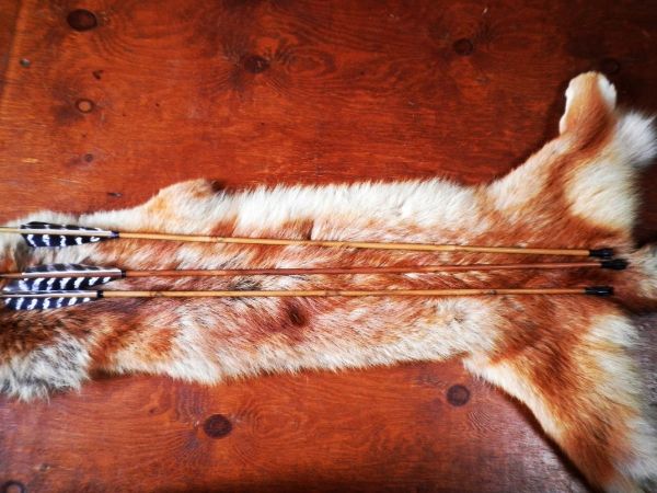

        Nothing fancy. 31.5″ bamboo shafts. 200gr SGT makes a 684gr FOC 17% killer arrow!
        FOC is a bit low but these things are flying great out of my 51# boo bow. No need for me to mess with them anymore.
        What I like the most out of these is that they are all within 5 grains!
        Taking them out jack hunting tomorrow morn.

                Thanks guys! 1 jack down, 2 misses. I’m tryin to get in under 20 yards with these bunnies but no luck!

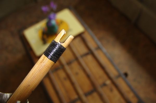

                    Hey G-monk, How did you do the nocks? Im going to try hardwood inserts on my next batch. Can you show us a close-up of the fletch/ nock wraps,,,they look great.

                      Heres the pic
                      The nocks are cut with a dremel. I put 3 of the this abrasive discs on and cut just deep enough to get the throat around the string.
                      Then I take a round and flat needle file and bring it out to the right width for my string.
                      I clean up the nock with some folded up 200grit.
                      For the wrapping have some Brownell serving material that I use. I unwind/unbraid the serving to get a single ply. I use a dab of clear nail polish hardener to secure one end and then wrap tight. I seal it with some more polish hardener.
                      Superglue works fine but I find the polish to be easier to work with and waterproof.
                      I dont use inserts on heavy bamboo or cane. A good wrap is enough or you can set the nock just behind a node.

                        Hey thanks, I will be building some for sure. Nice clean work, I also can’t live without my Dremel.
                        Ernest
                          FYI: Most superglue is NOT waterproof. Zap-A-Gap IS waterproof, and LOCTITE makes waterproof superglue. Zap-A-Gap and some of the LOCTITE are gels.
                        • chamookman
                            Post count: 17
                            Grumpy – I use Titebond III to seal the sinew wrapping on My arrows with great sucsess.
