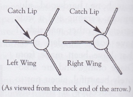

        I shoot right handed, which one should I use or does it matter? Why? Thanks!!:)
          Doesn’t matter so long as broadhead bevel matches feathers — either both left or both right. Otherwise they work against one another, trying to spin the arrow in opposite directions.

            I can’t remember which feathers I bought, how do you tell by looking at them?
              Here is a tip we published a while back that should explain it. A picture is worth a thousand words! 😀
              Single Bevel Broadheads

                Webmother wrote: Here is a tip we published a while back that should explain it. A picture is worth a thousand words! 😀
                Excellent! Thank you!
