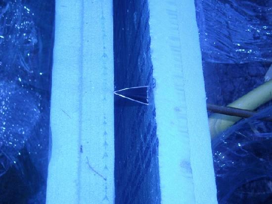

                              Just for a test (to see what kind of penetration I got) I used streach wrap (techy answer to duct tape) to hold 2 sheets of 2″ extruded styrofoam (bldg insulation) together and shot it with a broadhead. I got 3″ of penetration. Unfornatly I’m going to have to cut the broadhead out of the target, now I know, so I don’t have to do that again.
