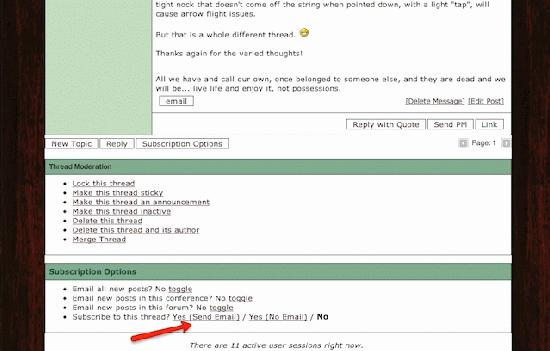

                                  Doc Nock, and anyone else who is interested, you can set it up to get emails when anyone posts in a thread by using the selections at the very bottom of the thread. Here is a picture to show what to click. Conversely, if you are getting emails about threads and you want them to stop, click the other link.

                                      Webmom,
                                      Yup. I got that “subscribe to thread” checked YES but never get nuttin… I hate computers often than not! ๐Ÿ˜›

                                          Doc Nock wrote: Webmom,
                                          Let me know if this works now.
