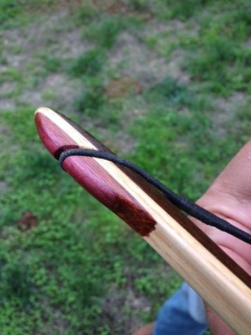

                    Here is a pic of a recent bow I made. Not a kids bow but I just love showing them!
                    Making bows sees to more addicting than shooting them!
                    Ill be making some more up in early Jan, a little build along would be fun!
