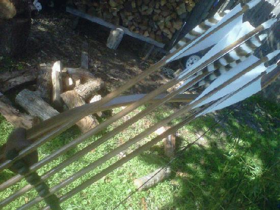

        Just a quick review here. Tred is not the subject here, just the arrows from 3Rivers that bare his name. I ordered a set to see how a lower priced factory POC arrow would perform, and the dozen I got are simply outstanding, that’s a testament to 3Rivers more than anything I guess.
        I got them full length, only 2 had to be hand straightened, and only just a tiny bit. Cut them to 29 1/2 inches with a serrated steak knife (worked great)for a 28 1/2 inch arrow after tapering, I used the $5 plastic taper tool also from 3R, great tool! Mounted 160gr field points on 6 arrows (mounting 160gr ACE broad heads on the other 6 later). Spine wt. of 60/65 for a 50 pound recurve. Shot them today, they fly straight and hit hard, the fletchings seem to have more of a spiral to them than most arrows I’ve seen and they really spin fast.
        All in all a great set of arrows for relatively cheap, just my 2 cents:D Have a great late season everyone!
