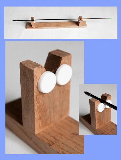

        I threatened to put up a photo of a homemade arrow spinner when I got it done. I didn’t think it would take several months to get to an hour long project, but here it is.
        Nothing fancy, but it seems to work great. I used a piece of board that was laying around since I bought the house and a pack of furniture gliders. I bought a set of nice ones, but then opted for the cheap ones instead. The cheap ones are hard nylon all the way around. The nice ones have a soft plastic ring around them which I thought might keep the shaft from spinning freely. The cheap ones also had a nail installed into the disk. I looked at rollers, but a lot of the less expensive ones didn’t seem to roll exactly on center. These won’t move so the arrow is the only thing spinning.
        The whole thing might have taken a bit more than an hour and cost about $1.39 plus tax (tacks included).
          Cool, David. Sure beats rolling them on a corner of a countertop, as I do. Thanks for posting this. Dave
            Thanks. A fun project on a rainy day. It’ll come in handy when I’m mounting my broadheads. Best, d
