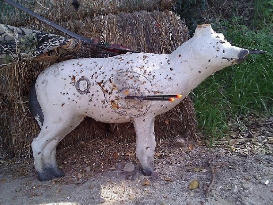

                                  OK, so I know I will get hammered for this, but here goes:
                                  I’ve got about 28% foc on my arrow (I gained about 1% by using the short AA fletching). I also had to balance my jo-jan fletcher feather clamps while making the arrow as they were unbalanced with the short fletch and the back end wanted to lift off… No big deal, just unexpected…
                                  I shot the arrow at my usual practice distance of about 19 yds and everything looked good. It was sort of disconcerting because I could not follow the arrow as well as with my normal length fletching.
                                  Then I moved to my deer target. I have a spot where I can shoot through some small juniper branches that are 6 ft or so in front of the target. When I did this, the arrow ended up stuck in the nose of the target. I repeated several more times, but it only happened once. It has never happened with my regular arrows. My normal experience is that high foc arrows pile drive through thin brush without deviation.
                                  Then I took the arrow on my archery night out at the local shop. I shot the arrow for about 3 hours, along with my other arrows which are the same except for the fletching length. I found that if I had a crappy release (I am very familiar with crappy releases :oops:) that should have had my arrow a couple inches off the mark, it ended up being 6 or 7 inches off the mark.
                                  The arrows bare shaft tune like darts. What am I doing wrong? Is 28% not enough?

                                      Steve, it sounds like you need to increase the size of your fletching slightly. Go slow, increasing just 1/4″ at a time until you have total flight stability under all shooting conditions.
                                      Here’s a cut-and-past from a previous post on the step by step tuning I do for the A&A fletching. It sounds like you are at step 5, which I’ve marked in ‘bold’.
                                      I tune the fletching to give the smallest fletching that will stabilize the broadhead under all shooting conditions. I prefer the A&A fletching pattern, which utilizes a turbulator forward of the fletching. Here’s the process I use to tune the A&A fletching, but the same process works for determining the minimum size for any fletching pattern. Just as when bare shaft tuning, finding the minimum amount fletching is a step by step process.
                                      1. Once you feel that you have the bare shaft tuned correctly, mount a matched-weight broadhead on one of the shafts. First use what you are absolutely certain is ample fletching to stabilize the broadhead and VERIFY that the fletched-shaft/broadhead has identical impact to the field-point tipped bare shaft. You can use any fletching pattern you like for this step.
                                      2. Once your shaft tuning is verified you can begin tuning the fletching. Switch to the A&A fletching pattern on the broadhead tipped shaft, starting at about 5” length if you are using 3-fletch, or 4” if using 4-fletch. DO NOT add the turbulator yet. Shoot the arrow several times and check the flight stability.
                                      3. If all is well, begin to gradually decrease the length of the A&A fletchings until the point where you FIRST see a slight instability in the arrow’s flight. Be sure to shoot several shots before making a decision on the flight stability, and it helps if you can have another person also watching for flight instability too.
                                      4. Now add the turbulator and check to be sure the flight is again completely stable. If addition of the turbulator does not completely stabilize the arrow’s flight increase the fletching length by ¼” and check again, with the turbulator in place.
                                      Many factors affect what’s the minimum A&A fletching that will work FOR YOU. A big factor is quality of your release (mine’s poor). Other major factors are the type of broadhead (how much wind shear it generates) and the amount of FOC on the arrow and the shaft’s length. Your draw length and whatever length shaft you are using are also factors. At a given amount of FOC, the longer the shaft the less fletching required; because of the lengthened rear steering arm. Your draw length vs. shaft length affects the point of maximum shaft flex upon release.
                                      5. Once you feel you have the fletching at the minimum size for stability there’s only two tasks remaining; (1) shoot the arrow a lot to verify that there is sufficient fletching to stabilize the arrow even when you get a bad release and (2) check arrow flight on a windy day. When checking for flight in windy conditions you will want to take shots at as many angles to the wind as possible, but at an absolute minimum check the arrow’s flight in a full cross-wind and both quartering with and quartering into the wind. If there is any problem with stability in either of these tests you should increase the length of the fletching gradually, in ¼” increments, until the arrow shows stable flight under all conditions of release and wind direction.
                                      I’ve not found any release or wind direction problems when using the high MA single blade broadheads, because of their very low wind shear factor, but many of the wide-narrow broadheads require an increase in fletching area to achieve flight stability in quartering wind conditions.
                                      This sounds like a lot of work, and it is, but it is a one time job for a given arrow setup. It’s analogous to a working up the very best handload for a rifle; and cheaper and easier to accomplish than finding the best rifle handload too!
                                      I hope the foregoing is coherent enough to be understood. If not lets kick the subject around a bit and see if we can clarify anything that’s in doubt.

                                            Post count: 2433
                                            Thanks for the tips!
                                            The fletching is 2 1/2″ long now. As suggested I’ll increase 1/4″ and try again…
                                            I can group my bare shafts as well as fletched shafts, as King says. So hopefully just a little more fletching will do.

                                                            I was interested in these short fletchings because I wanted to try to get more fletch from each feather. Maybe this wasn’t a good reason.
                                                            I finally figured out why I couldn’t follow the arrow in flight so well as my usual arrows. My usual arrows spin so fast, that the back end looks like a semi-solid disk the diameter of the fletch. The A&A don’t spin nearly so fast, and so my eye had to settle on the actual fletch to see them. Once I realized this, I could easily follow the arrows.
                                                            I increased the length of the fletching to 3 inches and the arrow behaved better. But it just doesn’t give me the forgiveness of my usual arrows. And as my wife says, I need all the forgiveness I can get 😳
                                                            But I am getting a take away from this. I started adding the turbulator to my arrows last year with measurable results. Now I am adding the straight back edge to my regular fletching. this moves the feather closer to the nock and gets rid of the “non working” length at the back of the fletch.
                                                            I was way off on my FOC calculation. I believe I said I had 28%. In truth, it is 21%. Experimenting to see what it would take to get me to 30%, I found that the needed additional weight was not acceptable to me.
                                                            It’s been a while since I gave my arrows the hairy eyeball. It was fun to fiddle and get a little something out of it. I thought later this summer (after my bear hunt in May) I may get some carbon impact whitetail shafts that have a weight of about 5 gpi (about half my GT 9.something gpi) and see if I can get the FOC better without making the arrows weight more than 13 gpp.
